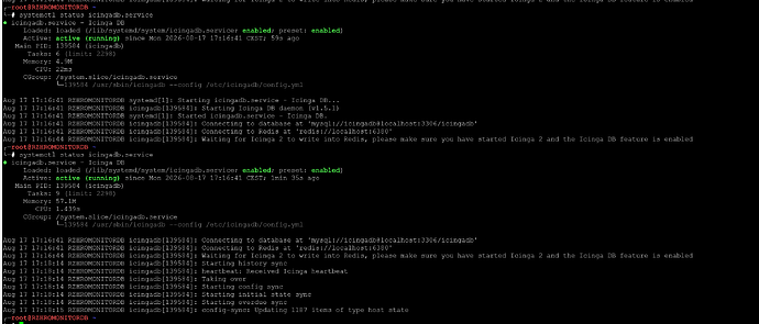

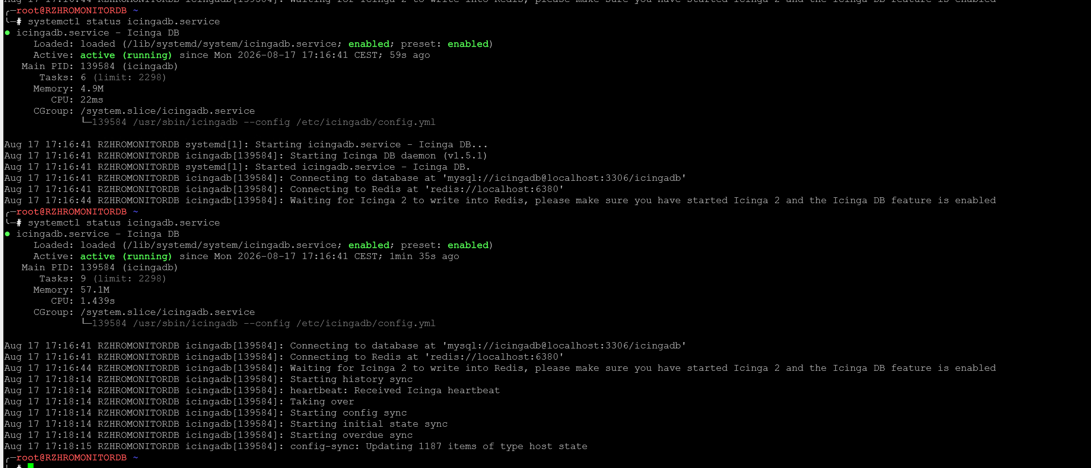

After restarting the icingadb.service the db is running again but crash after several hours.
! corrention !
The icingadb carshes if someon deploys with the Icinga-Director. 20 seconds after rollout the icingadb.services crashes
Montag, 17. August 2026
[admin.xy modify service "systemd"		17:13:18
[admin.abc] modify host "Host162"		11:54:46
[admin.abc] modify host "Host162"		10:50:56
╰─# journalctl -u icingadb --since "2026-08-17 10:00" -f | grep Failed -C 3
Aug 17 10:51:13 RZHROMONITORDB icingadb[23493]: config-sync: Updating 1187 items of type host state
Aug 17 10:51:14 RZHROMONITORDB icingadb[23493]: unexpected Redis schema version: "5" (expected "6"), please make sure you are running compatible versions of Icinga 2 and Icinga DB
Aug 17 10:51:14 RZHROMONITORDB systemd[1]: icingadb.service: Main process exited, code=exited, status=1/FAILURE
Aug 17 10:51:14 RZHROMONITORDB systemd[1]: icingadb.service: Failed with result 'exit-code'.
Aug 17 10:51:14 RZHROMONITORDB systemd[1]: icingadb.service: Consumed 1h 9min 21.985s CPU time.
Aug 17 10:59:24 RZHROMONITORDB systemd[1]: Starting icingadb.service - Icinga DB...
Aug 17 10:59:24 RZHROMONITORDB icingadb[127288]: Starting Icinga DB daemon (v1.5.1)
Aug 17 11:55:02 RZHROMONITORDB icingadb[128582]: Icinga 2 started a new config dump, waiting for it to complete
Aug 17 11:55:02 RZHROMONITORDB icingadb[128582]: unexpected Redis schema version: "5" (expected "6"), please make sure you are running compatible versions of Icinga 2 and Icinga DB
Aug 17 11:55:02 RZHROMONITORDB systemd[1]: icingadb.service: Main process exited, code=exited, status=1/FAILURE
Aug 17 11:55:02 RZHROMONITORDB systemd[1]: icingadb.service: Failed with result 'exit-code'.
Aug 17 11:55:02 RZHROMONITORDB systemd[1]: icingadb.service: Consumed 33.484s CPU time.
Aug 17 11:56:55 RZHROMONITORDB systemd[1]: Starting icingadb.service - Icinga DB...
Aug 17 11:56:55 RZHROMONITORDB systemd[1]: Started icingadb.service - Icinga DB.
Aug 17 17:13:33 RZHROMONITORDB icingadb[130103]: Icinga 2 started a new config dump, waiting for it to complete
Aug 17 17:13:33 RZHROMONITORDB icingadb[130103]: unexpected Redis schema version: "5" (expected "6"), please make sure you are running compatible versions of Icinga 2 and Icinga DB
Aug 17 17:13:33 RZHROMONITORDB systemd[1]: icingadb.service: Main process exited, code=exited, status=1/FAILURE
Aug 17 17:13:33 RZHROMONITORDB systemd[1]: icingadb.service: Failed with result 'exit-code'.
Aug 17 17:13:33 RZHROMONITORDB systemd[1]: icingadb.service: Consumed 4min 47.235s CPU time.
Aug 17 17:16:41 RZHROMONITORDB systemd[1]: Starting icingadb.service - Icinga DB...
Aug 17 17:16:41 RZHROMONITORDB icingadb[139584]: Starting Icinga DB daemon (v1.5.1)

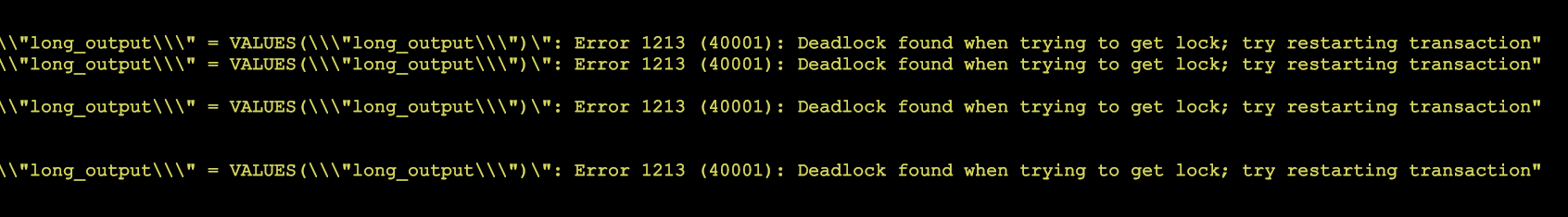

Aug 19 14:17:22 RZHROMONITORDB icingadb[240535]: runtime-updates: Upserted 1 HostState items
Aug 19 14:17:25 RZHROMONITORDB icingadb[240535]: Icinga 2 started a new config dump, waiting for it to complete
Aug 19 14:17:25 RZHROMONITORDB icingadb[240535]: history-sync: Synced 17 state history items
Aug 19 14:17:25 RZHROMONITORDB icingadb[240535]: Starting config sync
Aug 19 14:17:25 RZHROMONITORDB icingadb[240535]: Starting initial state sync
Aug 19 14:17:25 RZHROMONITORDB icingadb[240535]: Starting overdue sync
Aug 19 14:17:26 RZHROMONITORDB icingadb[240535]: config-sync: Updating 1187 items of type host state
Aug 19 14:17:26 RZHROMONITORDB icingadb[240535]: Icinga 2 started a new config dump, waiting for it to complete
Aug 19 14:17:26 RZHROMONITORDB icingadb[240535]: config-sync: Aborted initial state sync after 1.528961097s
Aug 19 14:17:26 RZHROMONITORDB icingadb[240535]: config-sync: Aborted config sync after 1.529004427s
Aug 19 14:17:26 RZHROMONITORDB icingadb[240535]: Starting config sync
Aug 19 14:17:26 RZHROMONITORDB icingadb[240535]: Starting initial state sync
Aug 19 14:17:26 RZHROMONITORDB icingadb[240535]: Starting overdue sync
Aug 19 14:17:26 RZHROMONITORDB icingadb[240535]: config-sync: Deleting 1187 items of type host
Aug 19 14:17:26 RZHROMONITORDB icingadb[240535]: config-sync: Deleting 1187 items of type host state
Aug 19 14:17:26 RZHROMONITORDB icingadb[240535]: config-sync: Deleting 2075 items of type host customvar
Aug 19 14:17:26 RZHROMONITORDB icingadb[240535]: config-sync: Deleting 3402 items of type hostgroup member
Aug 19 14:17:27 RZHROMONITORDB icingadb[240535]: config-sync: Deleting 694 items of type downtime
Aug 19 14:17:27 RZHROMONITORDB icingadb[240535]: config-sync: Deleting 230 items of type comment
Aug 19 14:17:27 RZHROMONITORDB icingadb[240535]: config-sync: Deleting 11256 items of type service
Aug 19 14:17:27 RZHROMONITORDB icingadb[240535]: config-sync: Deleting 8865 items of type servicegroup member
Aug 19 14:17:27 RZHROMONITORDB icingadb[240535]: config-sync: Deleting 15095 items of type notification user
Aug 19 14:17:27 RZHROMONITORDB icingadb[240535]: config-sync: Deleting 724 items of type endpoint
Aug 19 14:17:27 RZHROMONITORDB icingadb[240535]: config-sync: Deleting 1 items of type usergroup
Aug 19 14:17:27 RZHROMONITORDB icingadb[240535]: config-sync: Deleting 11000 items of type notification recipient
Aug 19 14:17:27 RZHROMONITORDB icingadb[240535]: config-sync: Deleting 3 items of type icon image
Aug 19 14:17:27 RZHROMONITORDB icingadb[240535]: config-sync: Deleting 1 items of type notification usergroup
Aug 19 14:17:27 RZHROMONITORDB icingadb[240535]: config-sync: Deleting 14785 items of type service customvar
Aug 19 14:17:27 RZHROMONITORDB icingadb[240535]: config-sync: Deleting 1043 items of type customvar
Aug 19 14:17:27 RZHROMONITORDB icingadb[240535]: config-sync: Deleting 1494 items of type customvar flat
Aug 19 14:17:27 RZHROMONITORDB icingadb[240535]: config-sync: Updating 1 items of type zone
Aug 19 14:17:27 RZHROMONITORDB icingadb[240535]: config-sync: Deleting 724 items of type zone
Aug 19 14:17:28 RZHROMONITORDB icingadb[240535]: config-sync: Deleting 6 items of type checkcommand envvar
Aug 19 14:17:28 RZHROMONITORDB icingadb[240535]: config-sync: Deleting 25 items of type checkcommand
Aug 19 14:17:28 RZHROMONITORDB icingadb[240535]: config-sync: Deleting 35 items of type checkcommand customvar
Aug 19 14:17:28 RZHROMONITORDB icingadb[240535]: config-sync: Updating 1498 items of type service state
Aug 19 14:17:28 RZHROMONITORDB icingadb[240535]: config-sync: Deleting 9756 items of type service state
Aug 19 14:17:28 RZHROMONITORDB icingadb[240535]: config-sync: Deleting 171 items of type checkcommand argument
Aug 19 14:17:28 RZHROMONITORDB icingadb[240535]: database: Can't execute query. Retrying        error="can't perform \"INSERT INTO \\\"service_state\\\" (\\\"check_source\\\", \\\"execution_time\\\", \\\"last_update\\\", \\\"latency\\\", \\\"in_downtime\\\", >
Aug 19 14:17:29 RZHROMONITORDB icingadb[240535]: database: Can't execute query. Retrying        error="can't perform \"INSERT INTO \\\"service_state\\\" (\\\"check_source\\\", \\\"execution_time\\\", \\\"last_update\\\", \\\"latency\\\", \\\"in_downtime\\\", >
Aug 19 14:17:29 RZHROMONITORDB icingadb[240535]: config-sync: Deleting 89 items of type notification
Aug 19 14:17:29 RZHROMONITORDB icingadb[240535]: Starting config runtime updates sync
Aug 19 14:17:29 RZHROMONITORDB icingadb[240535]: config-sync: Finished config sync in 2.241622792s
Aug 19 14:17:29 RZHROMONITORDB icingadb[240535]: database: Query retried successfully after error
Aug 19 14:17:29 RZHROMONITORDB icingadb[240535]: Starting history retention
Aug 19 14:17:29 RZHROMONITORDB icingadb[240535]: config-sync: Finished initial state sync in 2.812867548s
Aug 19 14:17:29 RZHROMONITORDB icingadb[240535]: Starting state runtime updates sync
Aug 19 14:17:45 RZHROMONITORDB icingadb[240535]: history-sync: Synced 6 state history items
Aug 19 14:17:46 RZHROMONITORDB icingadb[240535]: overdue-sync: Synced 1 host overdue indicators

Thanks for clarifying the single components, it get quite complicated when there is a feature called icingadb, a module and a daemon.
In my case I adopted the system in this state. I only set up for testing my own all in one VM Icinga2 setup couse I dint know much about K8s and Helcharts only some Docker.
But it seems that the error is fixed.
I have disabled the icingadb feature on the DB and Icingaweb host.
Both where activated.
The config was commented out but on the icinga web not and there was de Adress of the icingadb-redis server.
So someon thought that he has configured the module instead of had the feature.
