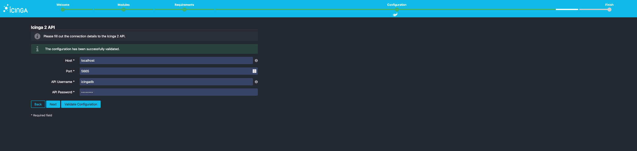

Icingaweb2/IcingaDB-Web2 Setup
Now we finally enter the Web Stage.

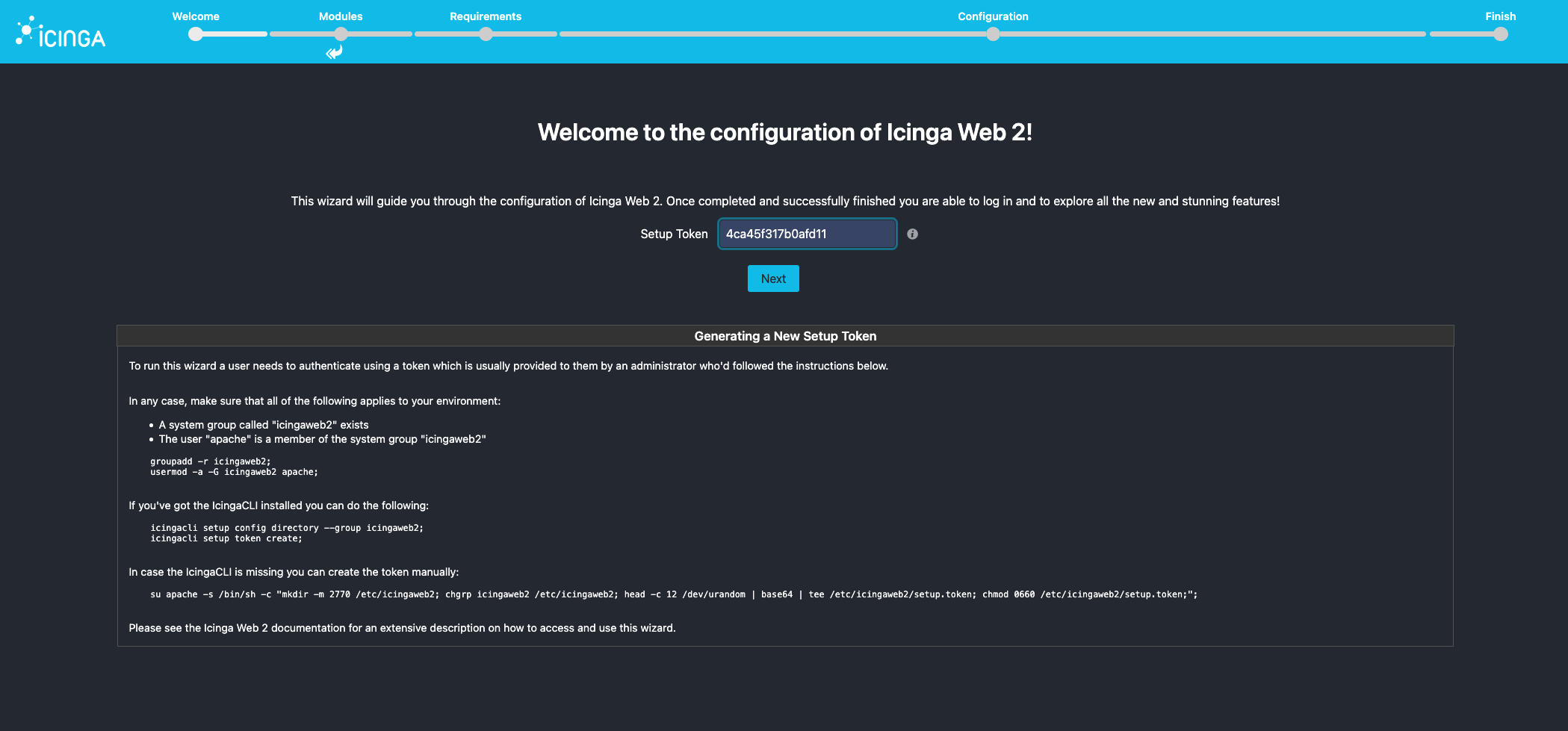

Lets begin with creating a setup token on the command line
icingacli setup token create
It should provide an output like this:
[root@testsystem icingadb]# icingacli setup token create
The newly generated setup token is: 4ca45f317b0afd11
And then we go to our web server address in my case
http://10.77.14.120/icingaweb2/setup
however the ip address can change and don’t be afraid there is no initial tis/ssl certificate

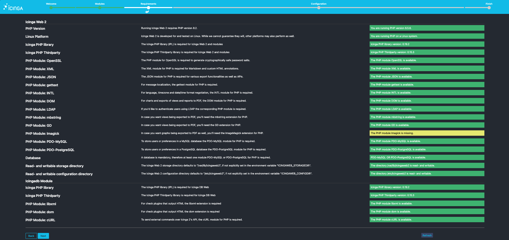

After entering the token we click next and will be furthermore greeted with a choice of the modules we can use .. we simply proceed and click next.

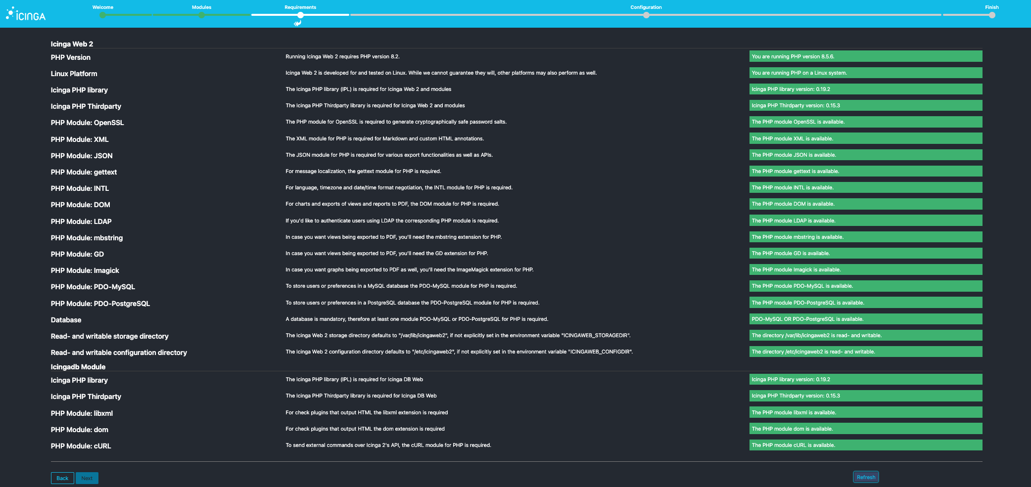

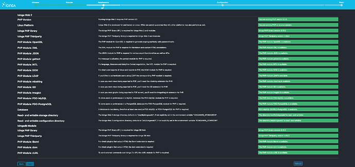

We see now a list of packages and checks which are necessary in our case imagick is missing so we would need to install it via
dnf install php-pecl-imagick.x86_64 -y
systemctl restart httpd.service
And then refresh the page. Now all should be green we proceed with clicking ‘next’.

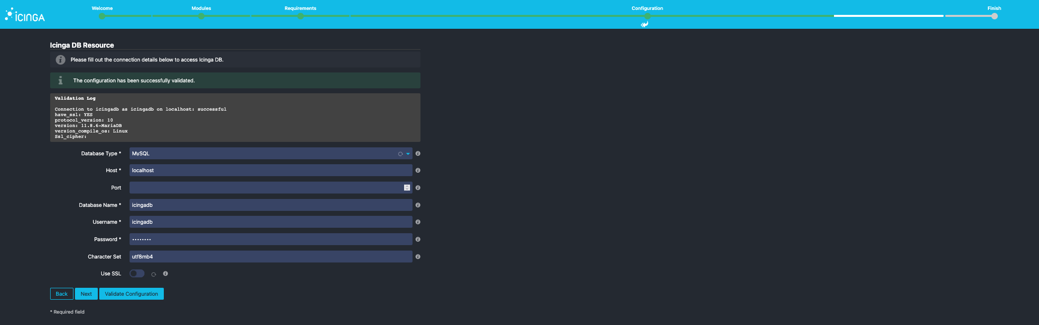

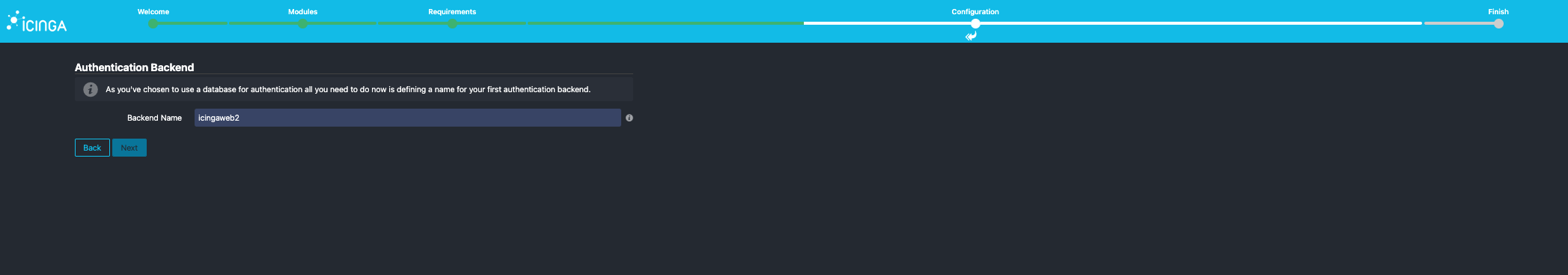

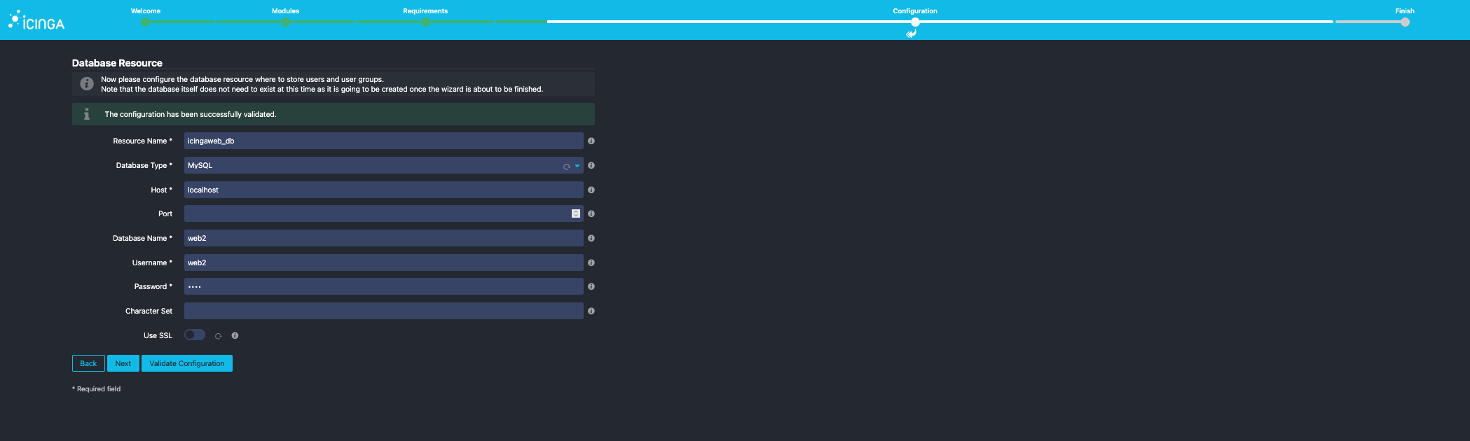

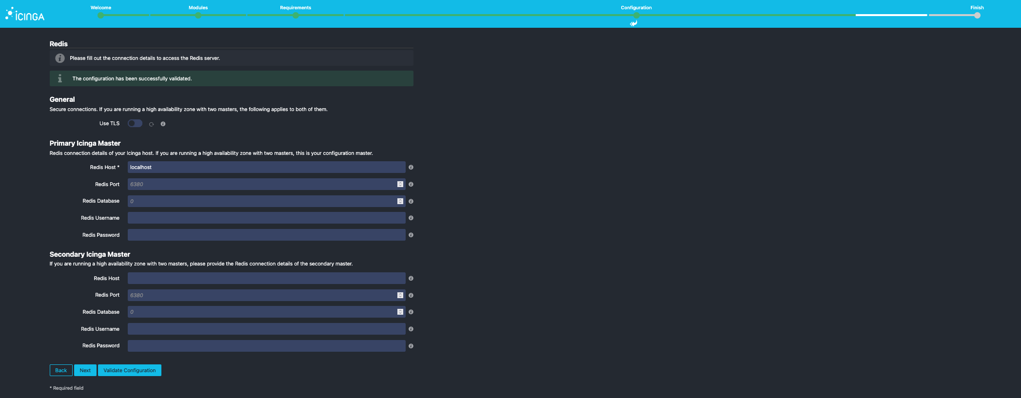

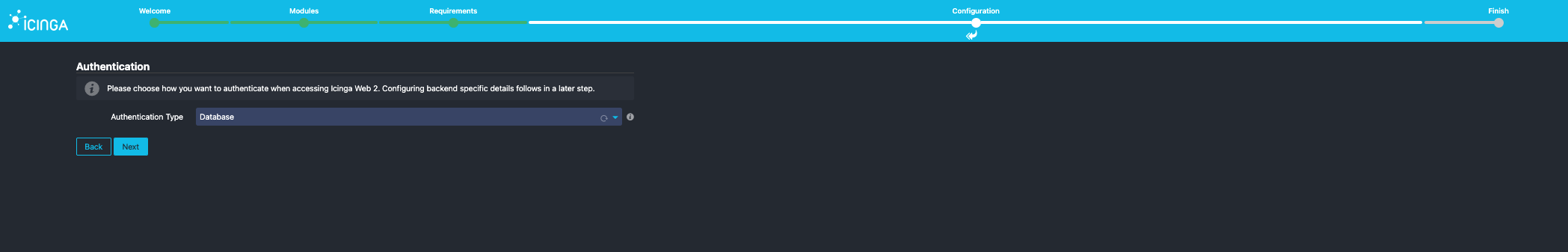

It will ask us now for the initial user database in this case we use the Web2 database we defined earlier.
First choice here is database then => next.
We fill out the required fields and then click validate.
Then proceed with => next
Now we can name the settings from before our user Backend is named icingaweb2.
We leave it at the default and move on clicking => ‘next’.

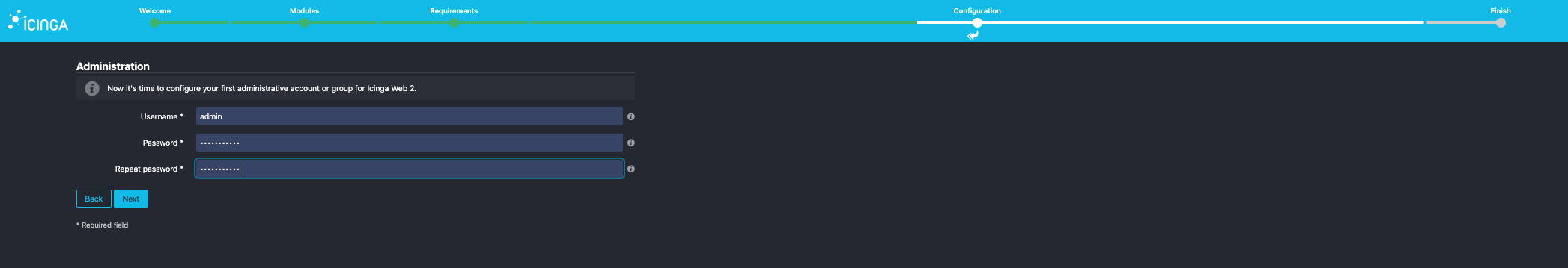

Next is the initial Administrative user we setup in the database.
I suggest naming him admin and give him a ‘supersecret’ password.

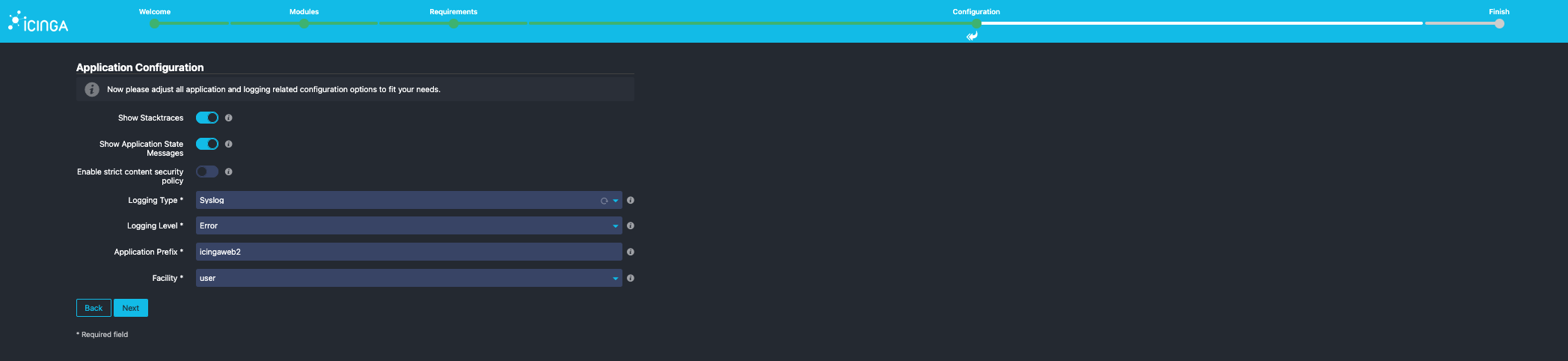

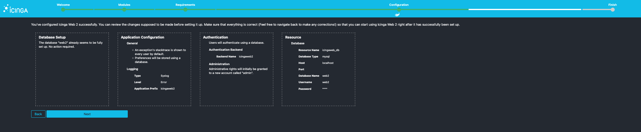

Now comes a further settings page which we leave at the default at this moment.
Click => next

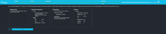

Then comes a summary page which we also skip with next.
Now we Enter the IcingaDB-Web configuration.
IcingaDB-Web Config
First we will be asked for the settings of the Database we created beforehand.
Database Name => icingadb
Username => icingadb
Password => icingadb
We might need to change the host address depending on the ip which might be necessary.
Also keep in mind that depending on your infrastructure you might need to adjust also the grants on the Database users in my example i used icingadb@localhost it might be something other in your infrastructure e.g. icingadb@192.168.172.1 as an Example.
We finish with a validate and then proceed with next
IcingaDB-Redis
As a RHEL based system redis wasn’t initiated until now so we enable it.
systemctl enable icingadb-redis.service --now
We now will be greeted with the icingadb-redis setup page.
In the default setting not much is needed we focus on the Primary master and simply enter the redis host field.
In our example case this is localhost it might be something else in your environment.
Might be 192.168.172.1 depending on the machine where the redis is installed.
Then we click => next

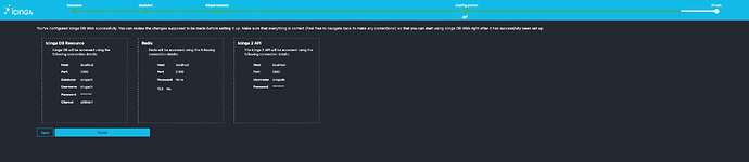

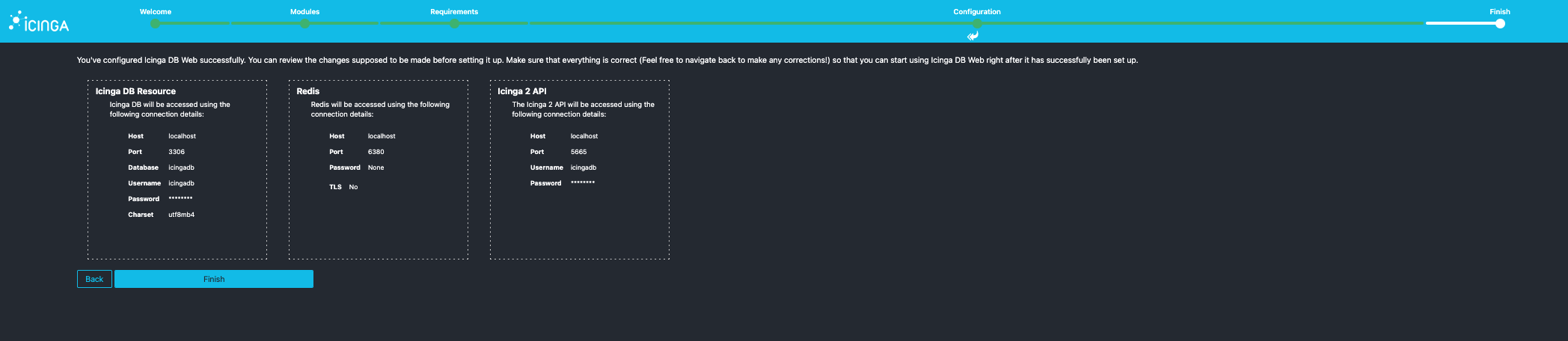

Icinga2 APi Setup
Now the Setup asks us for the api user we created before.
Host => localhost // like mentioned before this might be different in your environment
Port => 5665
Api Username => icingadb
Api Password => icingadb
We validate and then proceed with next
We enter a Summary Page and proceed with next

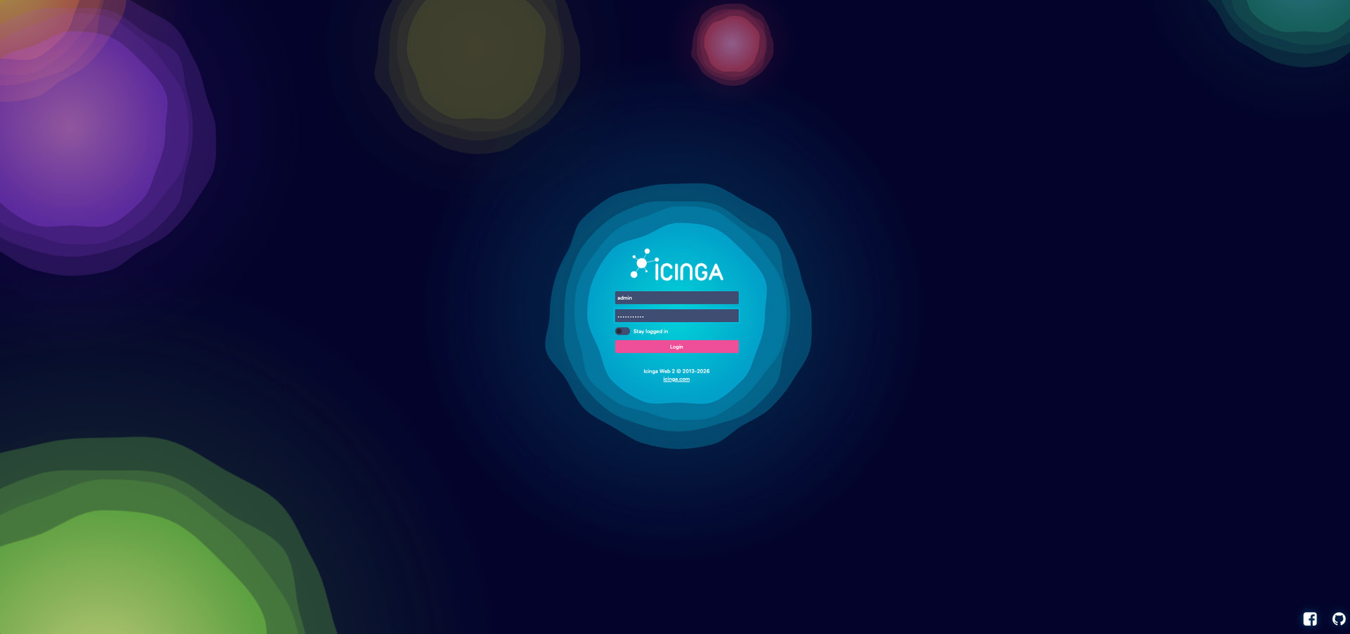

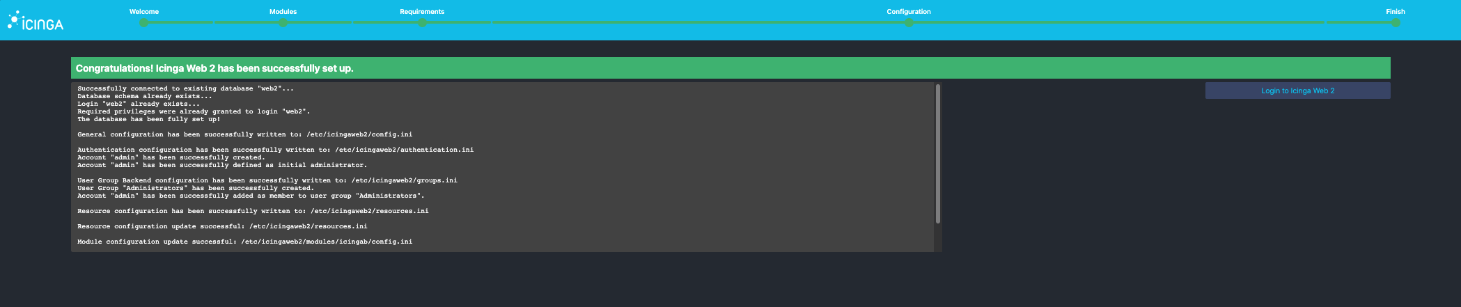

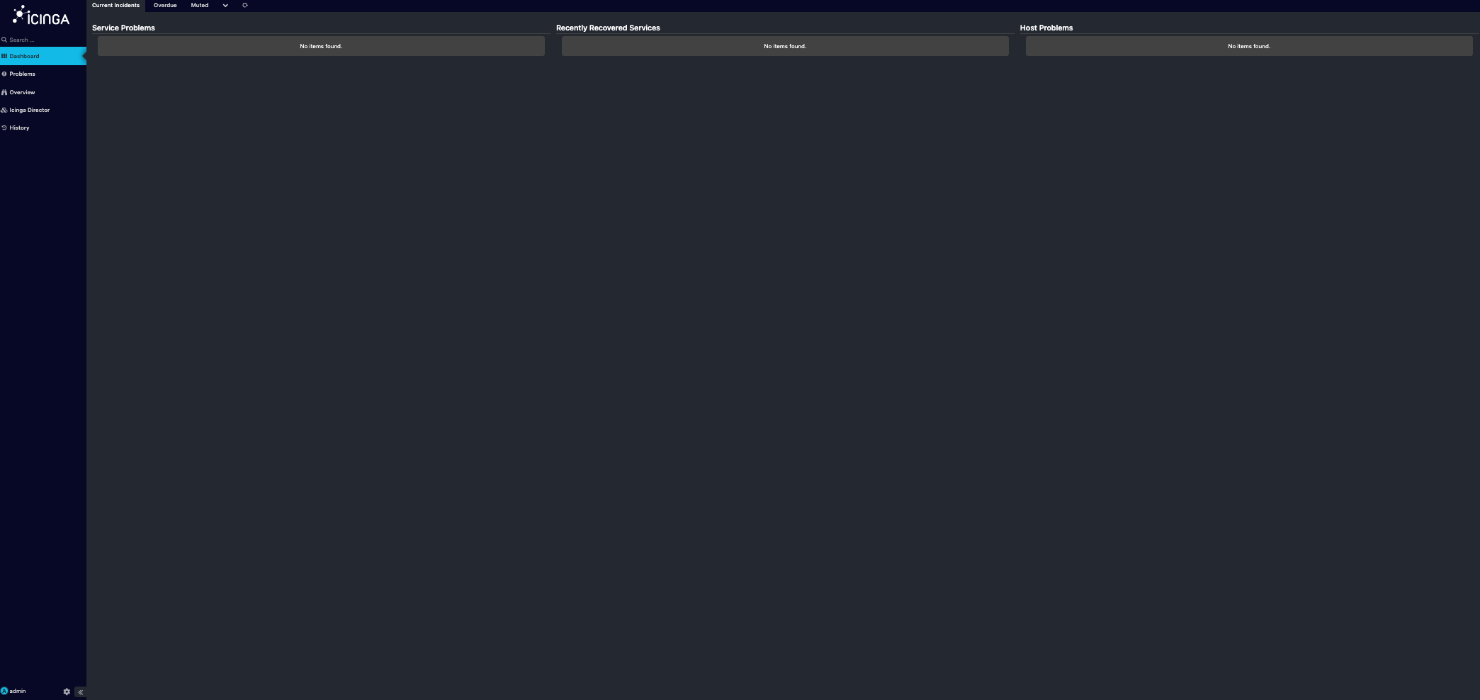

IcingaDB-Web Login Mask
We finished the installer and are now ready to log in
After we logged in with our credentials admin/supersecret
We are greeted with an empty icinga2.

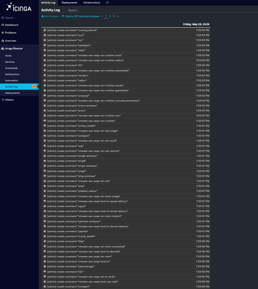

So we proceed to the setup of the icingaweb2 Director.

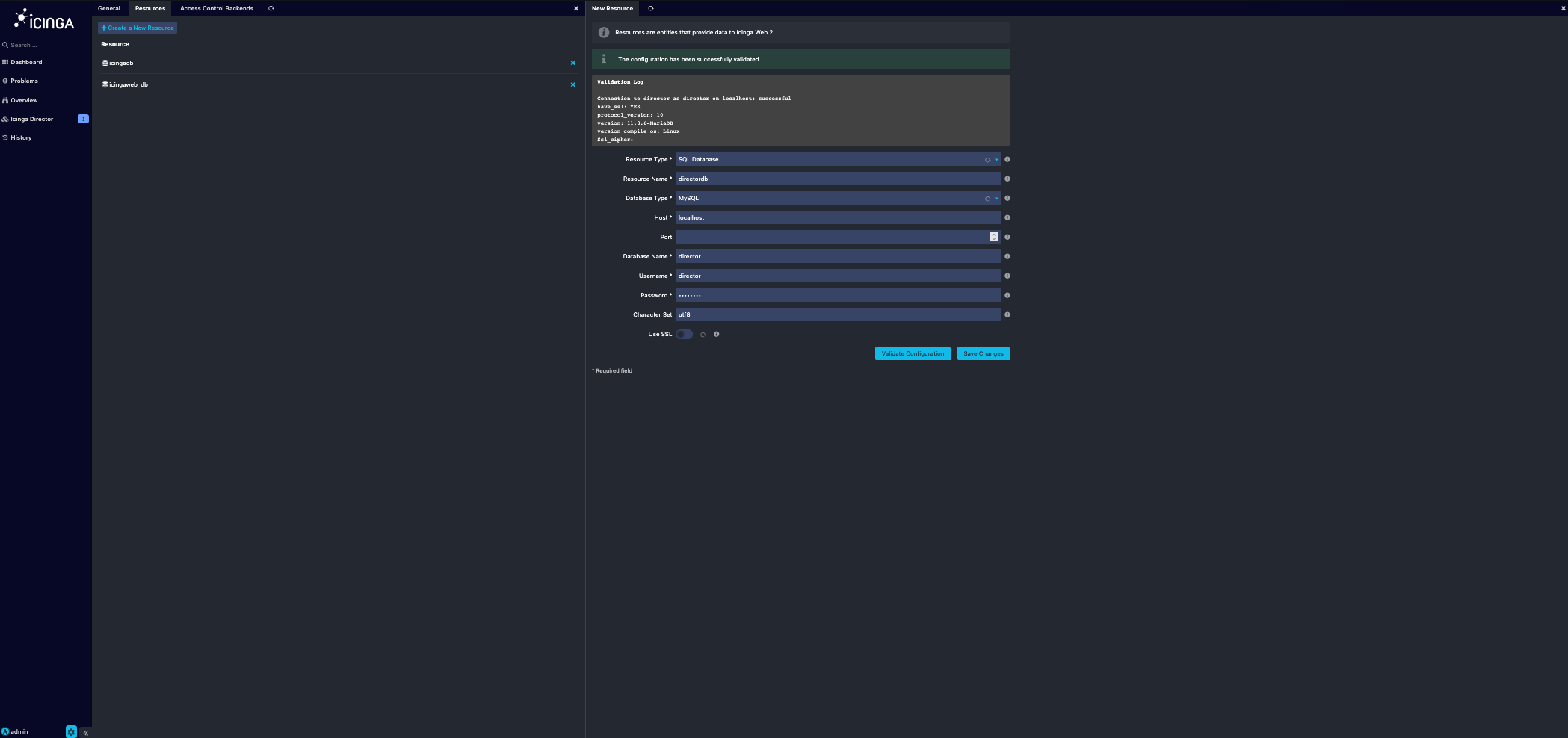

Icingaweb2 Director Setup
Inside the icingaweb2 interface we click the gear icon on the left down corner right beside our name.
Here we go to Application and then to the tab Resources.
We click on create a new resource.
We fill in the necessary fields and click then validate and save changes.

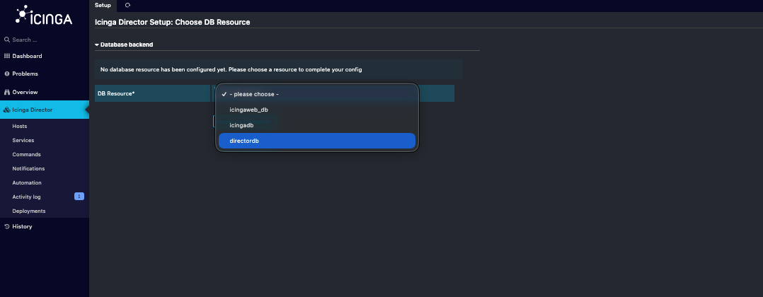

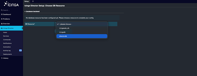

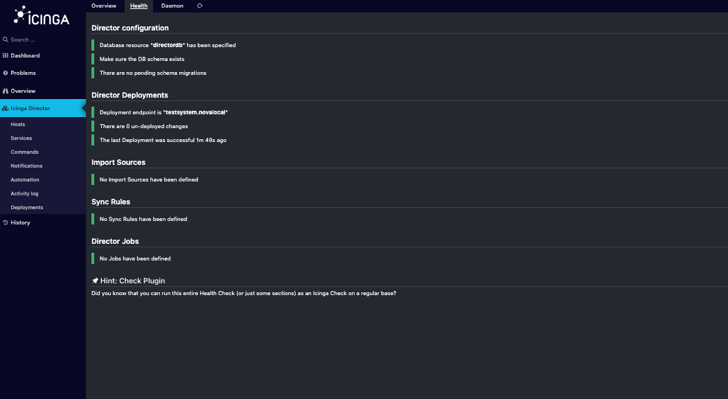

Then we click on the icinga director on the left side with the blue box.
We will be greeted with a dropdown box where we choose our database.

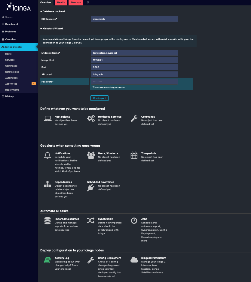

After that we will see the following Screen where we will enter some credentials needed for the Director to work.
First is the
Endpoint Name => testsystem.novalocal // this is the name of the machine sometimes the full hostfdqn
Icinga Host => 127.0.0.1 // IP Address of the instance this might differ in your setup
Api user => icingadb // usually you would create a new api user in the api-users.conf file
Password => icingadb // but we take the already created api user

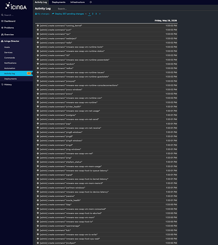

After that we hit import
And we now should see an activity log filled with changes.
After hitting deploy changes it might look like this.
You might run into some issues with the icing-director.service it needs enabling and started to get the new settings.
systemctl enable icinga-director.service --now
