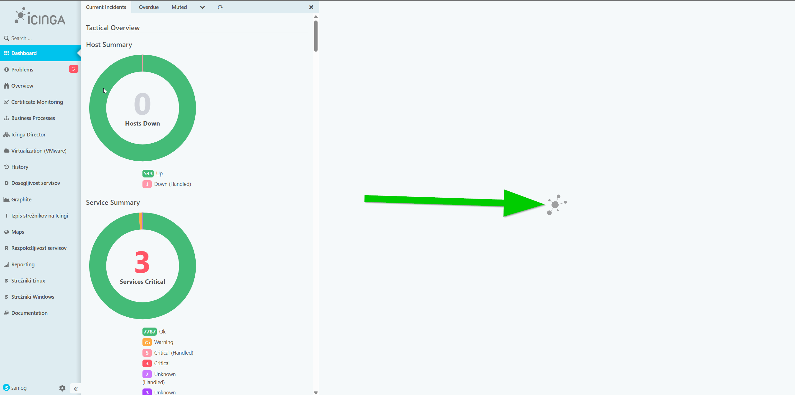

Random long response times in Icinga Web 2 when clicking on a service
Icinga has reponse times ranging sometimes from few to 15 seconds, when clicking on certain service or host on Icinga Web 2.
