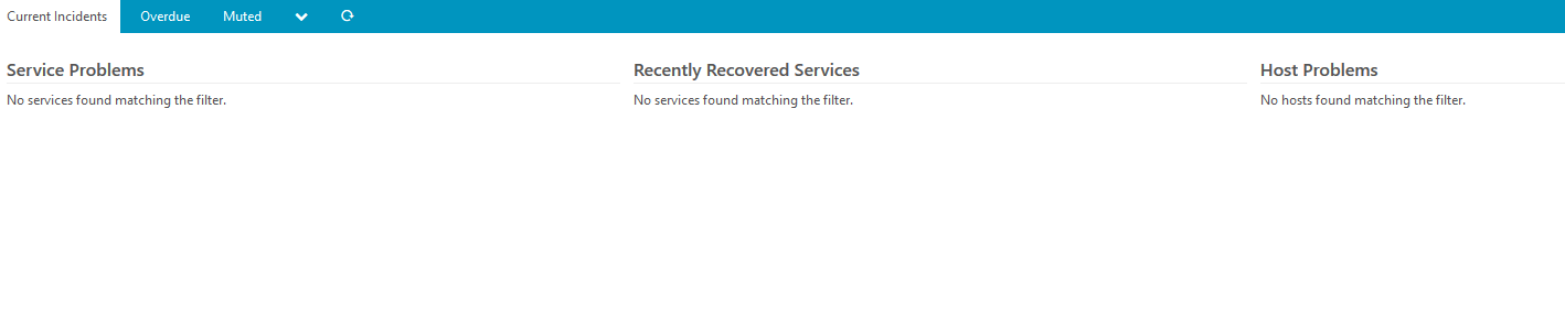

No services found matching the filter. | No services found matching the filter. Icingaweb
Hello, I am configuring icinga2, he configured the zones for a “MASTER” and an “AGENT” and the use of the ice agent to connect a windows client computer, I have connection to the certificates but when entering the http : // xxxx / icingaweb2 in any tag or drop-down shows me only the error:
No services were found that match the filter.
