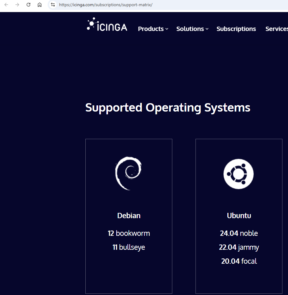

@GalipoliX I think you are searching for this: Icinga Ā» Subscriptions Ā» Support Matrix
the problem with this support matrix is, that ubuntu 20.04 should be supported
Yes, its a bad moment to link that matrix:D
I think outdated atm due to the recent release of 2.15, but i think it will be fixed soonish!
