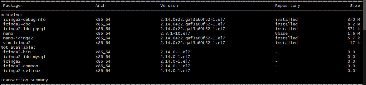

I was trying to undo the operation on my test setup, as you told me, with:
yum history undo last
but this unfortunately led to errors:
It was not able to rollback most of the icinga packages.
Therefore i am not able to test this in our prod environment.
Do you have a dual master test setup at netways, where you could test the packages?
Where did you get 2.14.0-1 from so that it’s not available now?

I rolled back my test vm today and tested the install und rollback again.
This time it worked without any issues, i am not sure what i did wrong last time.
