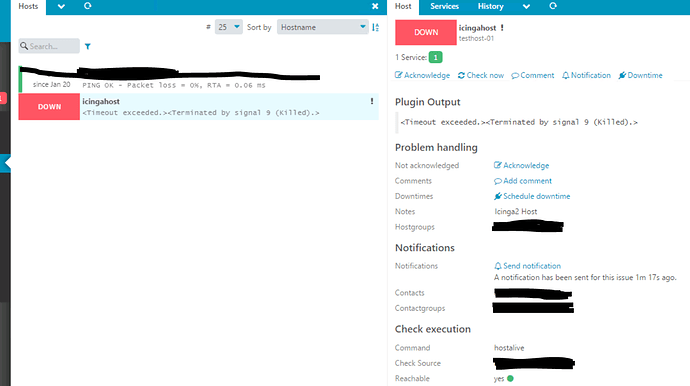

Maybe as clarification, these are my config Files:
hosts.conf
object Host "icingahost" {
    import "linux-host-template"
	address = "testhost-01"
	notes = "Icinga2 Host"
hosts
192.168.2.240		testhost-01
Result:
As a side note for the picture: The check source has a completely other name then the hostname itself, is that normal? And also, that green host that is already there, is the 127.0.0.1 localhost address that has the same name as the check source of my host I’m trying to configure here.
Edit: I just tried this with a different host, because I thought, maybe doing this with the same host one time with the localhost address and another time with it’s actual IP isn’t that smart, but the result is the same, it shows a DOWN state even though it’s reachable / pingable.
Best Regards
Andy
