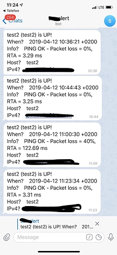

I have only the problem it sends all notifications but on the bot I only get the recover (UP) message :confused:
[2019-04-12 10:50:17 +0200] information/Checkable: Checking for configured notifications for object ‘test2’
[2019-04-12 10:50:17 +0200] information/Notification: Sending ‘Problem’ notification ‘test2!Host by Telegram’ for user ‘telegram_unixe’
[2019-04-12 10:50:17 +0200] information/Notification: Completed sending ‘Problem’ notification ‘test2!Host by Telegram’ for checkable ‘test2’ and user ‘telegram_unixe’.
But on the bot I got no notification
When it goes up again:
[2019-04-12 11:23:34 +0200] information/Notification: Sending ‘Recovery’ notification ‘test2!Host by Telegram’ for user ‘telegram_unixe’
[2019-04-12 11:23:34 +0200] information/Notification: Completed sending ‘Recovery’ notification ‘test2!Host by Telegram’ for checkable ‘test2’ and user ‘telegram_unixe’.
I’ll get a notification
Hm, your user templates and objects have the DOWN/Problem states and types defined, correct?
yes, on log you can see there ist sending a command but I think there is a bug in the script
when down then (i think this is a problem)
‘-o’ ‘<Terminated by signal 9 (Killed).>’ ‘-p’
when up
‘-o’ ‘PING OK - Packet loss = 20%, RTA = 4.10 ms’ ‘-p’
