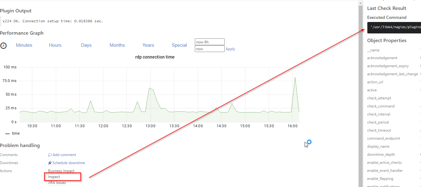

How does you commandline executed by icinga look like?
You can see that be checking the ‘Inspect’ link in the webinterface of the service

Thank you for showing me this feature. Never seen it before! :slight_smile:
'/usr/bin/icingacli' 'vspheredb' 'check' 'host' '--name' 'vm.intern.somewhere.de'
