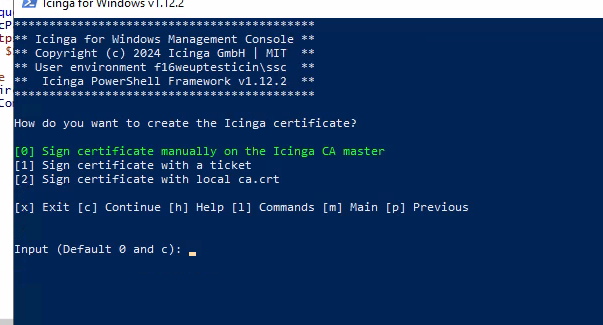

I have one more question about the certification process:
The framework offers following opportunities to choose:
Whats the best way for an automation Installation without manually interaction?

If I have to generate a ticket on the master and specify this in the script during the agent installation, then this contradicts an automated installation, as manual intervention is necessary before the installation, which is exactly what I want to prevent.
I could build an SSH connection to the master into my script, which creates the ticket on the master before the agent installation and transfers it to the installation, but that would probably not be the cleanest solution.
I don’t know SaltStack but I doubt, it will be difficult to fire a REST call to the Icinga2 API to get the ticket to then later insert it into the IwF install command.
