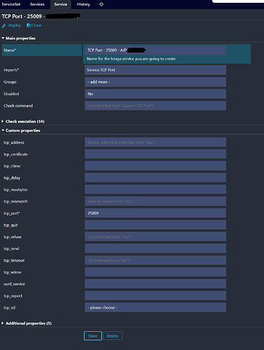

when Service-Sets are created the values of a service are usually inherited to the single hosts the service is assigned to. Here for instnace the Portnumber: 25009. At least i would expect so.
When I view the same Service assigned to the hosts the portnumber is missing. However the check itself is executed correctly with the port 25009:
‘/usr/lib64/nagios/plugins/check_tcp’ ‘-H’ ‘’ ‘-M’ ‘warn’ ‘-p’ ‘25009’ ‘-r’ ‘crit’ ‘-t’ ‘10’
The Icinga-Director View of the Service is missing the number.
Is this an expected behaviour? I would expect that the field tcp_port value is transparently passed over to the service object assigned to the host.

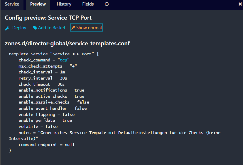

Could you share a printscreen of the “Preview” tab in “resolved” mode? The “Services” tab is probably not configured to show the correct custom properties.

Hi, thank you for your help!
This is the Service-Set snippet for the 25009 TCP-Check:
apply Service "TCP Port - 25009 - AJP XXX" {
    import "Service TCP Port"
    assign where host.name == "<fqdn>" || host.name == "<fqdn>"

and here the Service-template the service in the service-set is importing.
