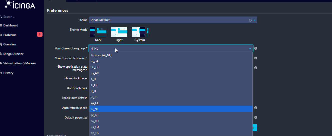

I am trying to use another language for webinterface. i have installed module translation and got package from L10n/locale/nl_NL/LC_MESSAGES at main · Icinga/L10n · GitHub. After restarting apache2 i have chose differents languages but the page is not translating,

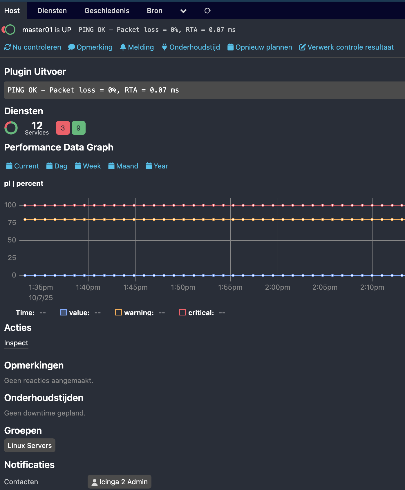

to get the translation feature in Icingaweb2 to work you have to make sure the corresponding language locals are installed on the server you are running your icingaweb2 instance.
If that’s the case then the translations are working fine as you can see in the provided screenshots.

On webinterface i can chose the langueage but stil after saving the config its stil keep English
