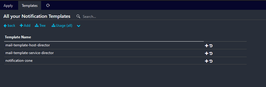

It’s time to log on to the Director web interface to use our template - here I’ve gone into Notifications → Notification Templates:

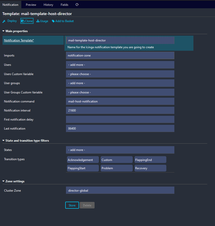

I can then modify my existing templates and import the new notification-zone that I’ve created:

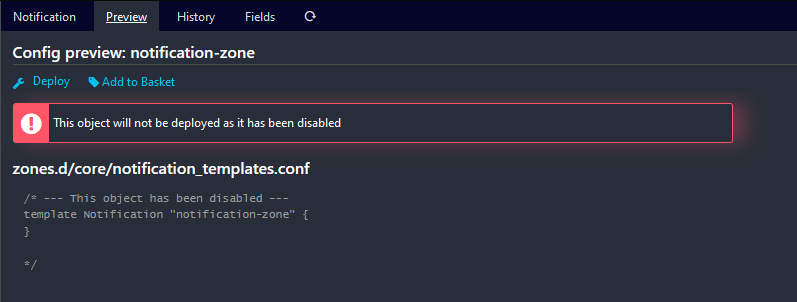

If you have a look at the notification-zone template inside the Director, you’ll see that it is disabled and that it won’t be deployed - this is OK - and exactly what we want, as we want our custom version to be deployed instead!
