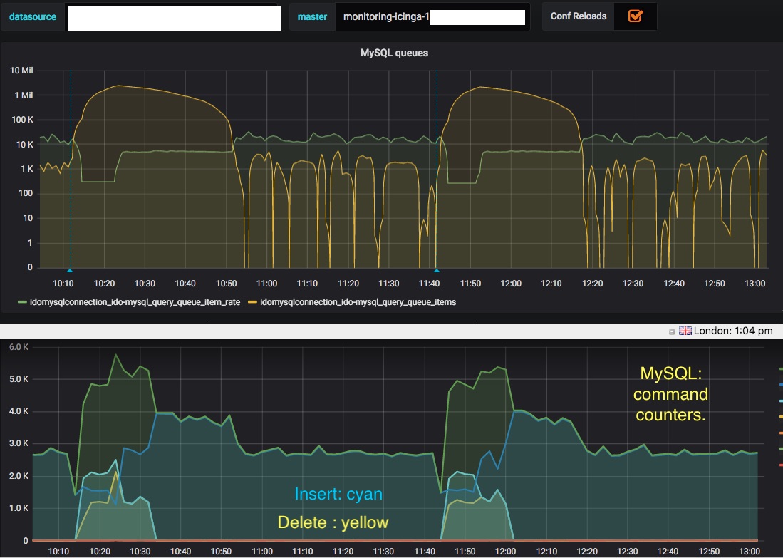

let’s get some context
information/ConfigItem: Instantiated 190632 Notifications.
information/ConfigItem: Instantiated 6278 Hosts.
information/ConfigItem: Instantiated 94349 Services.
I’m using A calculated value, to “randomly spread notifications” in time, as to avoid icinga getting OOM killed/stalled due to excessive notifications being sent simultaneously.

That way, I prevent All notifications being sent at once, this however causes the following issue:
  • upon configuration reload/update, Icinga sends nearly 15 minutes of inserts/deletes commands to mysql backend, causing the ido_mysql queues to skyrocket from avg 1000 items in queue up to 2.1 M items in queue. Issue is that notifications, and state information will only catch up in nearly after 45 minutes (that is 45 minutes without alerting !!!)
Since I suspect the variation of this value during configuration updates is somehow being persisted on the database, I was trying to migrate the function to something based on the “host” vars; i.e. “address” or “host.name” so that the function can be updated to some hashing value (like len of host.name or 10xsqrt(host.name)) and the performance hit is fully removed; but this in turn needs the object attributes and/or vars to be available during object creation (not really on api timing).
At the begining of the post; the function was addes as host.vars.notification_frequency; at the moment is being added to the notification object instead…
Do you think the problem has stated in a better manner now?
Is this notification.interval value trully being persisted somehow to database backend?
best regards,
Hi, I have just made the notification interval inmutable for each notification object, fixing the time required by database to update the field notification_interval on services and hosts table.
I’ll be closing the ticket.
