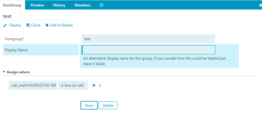

actually you could do something stupid…
here is an example with a host group apply rule:
cidr_match(“192.168.0.0/24”, host.address)
which is url encoded:
cidr_match%28%22192.168.0.0%2F24%22%2C%20host.address%29
but after you safe it it will look like that:
you can not save it again without url encoding
but it passes every check and deploys.
tested with icingaweb2 2.12.5 / director 1.11.5
but the best way would be a feature request on github for like plain query, with the notice that this can break your config.
and another workaround would be assigning hostgroups via plain icinga config files for the subnets and assigning dependecies based on the group.
or you use a custom var and assign the subnet to the host as textfield as well than you can do a equals match on for example host.vars.subnet
Best Regards
Nicolas
Thank you very much, Nicolas.
I have created a host group, and your trick also allows me to store the cidr_match filter in the director. I will now start building/testing the dependencies.

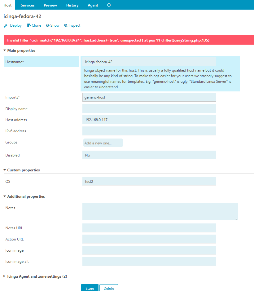

and there is a catch:
if I want to store a host Icinga director stores correctly but throws an error on re-evaluation.
this can be caused by the fact that hostgroups are evaluated during save because of permission options.
and this might be the issue with custom apply rules since every possible icingadsl variation needs to be evaluated in php to work with the groupapply rules and the permissions/restriction feature
I agree with @rivad that dsl injection is not a good idea and also added more stable alternatives:
To be honest, I can’t reproduce this problem. I only get the error when changing the host group, as you described earlier. Or does your screenshot already show the behaviour when a dependency is set up? Setting up dependencies once and then not being able to adjust them (easily) would be okay for me – but not being able to adjust hosts is a no-go.
