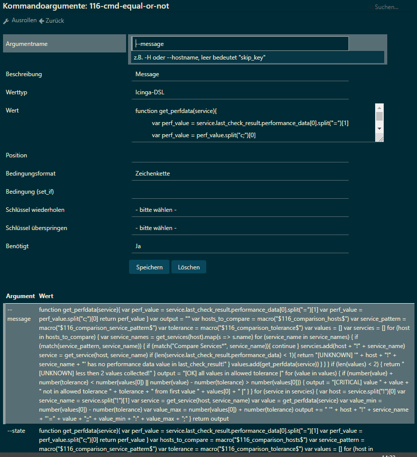

I use the Director and sprinkled in some DSL.
Mostly for Notifications and there are my checks that use results of services.
The first kind, I just manage outside of the director and the others I use the only place the Director allows DSL - Command Arguments. To get the result back into Icinga the Linuxfabrik wrote monitoring-plugins/check-plugins/dummy at main · Linuxfabrik/monitoring-plugins · GitHub for me.
Icinga is like Lego for monitoring, so spin up a test environment and start building!

This is, for example, a check that I use to compare 2 values with a allowed deviation - one from a DB check and the other from a file count check:
Sorry at the bottom the code gets garbled but in the input field you can copy paste with proper white spaces as you can see at Wert/Value.
Here the two code blocks with white space:

The dummy just reflects message and state back into icinga2 but all the DSL computatons are already done by the time dummy gets called so message and state look like this:
'/usr/lib64/nagios/plugins/dummy' '--message' '[OK] all values in allowed tolerance | '\''host1!servcie1'\''=26;;24:28; '\'host2!service2'\''=27;;24:28;' '--state' 'ok'
