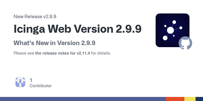

update icingaweb2 to at least, that should fix this issue:
But there is also a recent version with more security patches:
Problem solved. Thank you.
