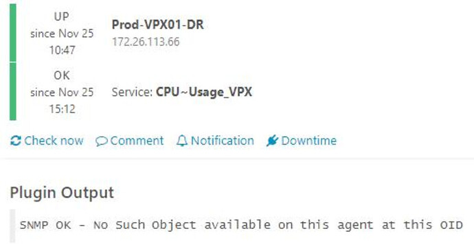

Hi Team,
Its noted that, i am not getting expected output in the Icinga UI with the snmp polling. I am using snmpV3 in my environment.
I am getting expected value while doing snmpwalk from the server. Please find the results below for your references:
[root@TRVUSTMMVLMON01 master]# snmpwalk -v 3 -u emadmin -a SHA -A ‘xxxxxx’ -l authPriv -x AES -X ‘xxxxxxx’ 172.21.113.66 1.3.6.1.4.1.5951.4.1.1.41.1
SNMPv2-SMI::enterprises.5951.4.1.1.41.1.0 = Gauge32: 1

Please see the various output of the snmp walk and check_snmp:
[root@TRVUSTMMVLMON01 plugins]# ./check_snmp -H 172.21.113.66 -P 3 -a SHA -x AES -U ‘emadmin’ -A ‘xxxxx’ -X ‘xxxxxx’ -L authPriv -o 1.3.6.1.4.1.5951.4.1.1.41.1
SNMP OK - No Such Instance currently exists at this OID |

I ran as icinga user and below is the input i am getting.
sudo -u icinga /usr/lib64/nagios/plugins/check_snmp -H 172.21.113.66 -P 3 -a SHA -x AES -U ‘emadmin’ -A ‘xxx’ -X ‘xxxx’ -L authPriv -o 1.3.6.1.4.1.5951.4.1.1.41.1 SNMP OK - No Such Instance currently exists at this OID
