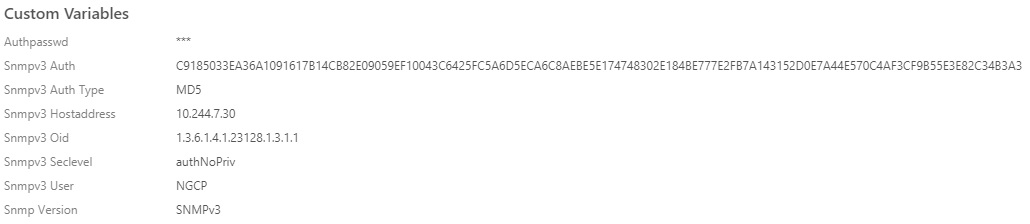

I’ve got an odd problem when attempting to template SNMP in Icinga Director. I have setup the required data fields and lists, applied them to a template, applied to the host, with the correct information filled in. However when the check executes I am met with the error:
snmp-auth-fail
This is where I’m confused. I’ve got two fields currently, one called ‘authpasswd (which stars out the password in the gui)’ and one named ‘snmpv3_auth’. Neither of these fields appear to be taken by the module as the authpasswd.
Any ideas as to why the snmpv3 module is ignoring these fields? Any help greatly appreciated.

Hi log1c,
Sorry for the delay, I had to update director. Here’s the running command:
'/usr/lib/nagios/plugins/check_snmp' '-A' '69616F4A45056E00A2D37CB1F6F1643FAE7D05B5167439ECB62EA58B454D1FC417FA4DE889DCF24F1175AF7354D6968297423D93BB714C2BD80D748BAE7F2075' '-H' '10.10.10.30' '-L' 'authNoPriv' '-P' '3' '-U' 'USER' '-a' 'SHA' '-o' '1.3.6.1.4.1.23128.1.3.1.1' '-t' '10' '-x' 'AES'
Now I can instantly see issues here. It’s attempting to use SHA, and also appears to be adding the privacy authentication used in authPriv. I have MD5 and authNoPriv in my Icinga configuration…
Any ideas why it’s adding these extras despite not being present in the service configuration on the host?
