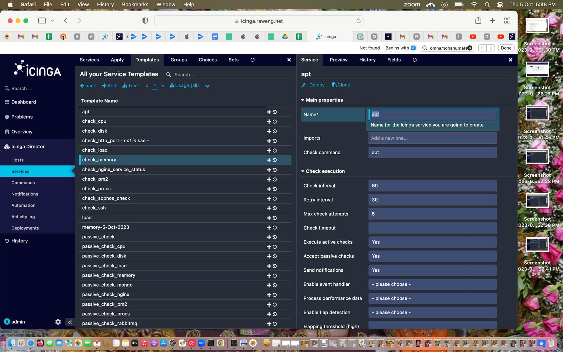

While creating service notification option is not there
Under Imports add generic-service.
Import is not giving an option for generic-service.
Then you have to add the custom variable enable_pagerduty with value true by yourself to such services. However, I’m not a Director pro.
Means do I need to add arguments and fields with name enable_pagerduty and value as true?
If possible please share documentation link for custom variable as I am at level zero for icinga setup so it will be very helpful!!

first create a datafield in icinga director name it enable_pagerduty since that the varname of you assign rule and use type boolean.
than you add the datafield to the service template or any root service template your servicetemplates can inherit from.
look at that thread, adding a field to a command is very similar to adding a field to a service
We will perform these steps and let you know if any help is require.
