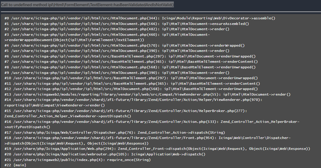

SLA report module is showing the error : Call to undefined method ipl\Html\FormElement\TextElement::hasBeenValidatedAndIsNotValid()
SLA values are fetching. But not able to modify the existing reports or create new reports. Getting the below error.

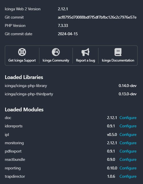

Please find the version details of the Icinga Web2, php, libraries and modules which we are using
why do you have the dev packages of icinga-php-library and icinga-php-thridparty installed?
also the current verison of reporting is 1.0.2
yours is 0.10 which is 3 years old by now (Mar 23, 2022)

also remove ipl and reactbundle these are deprecated.
