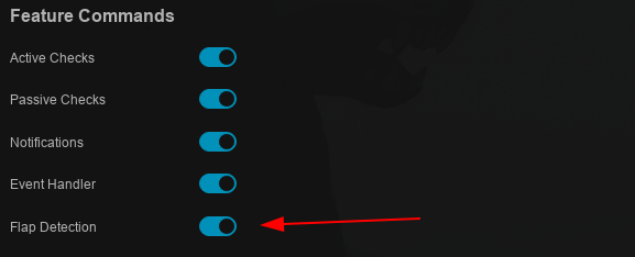

i’m currently working on a poorly handovered Icinga2 server. Flapping wasn’t impleented until yet but i want to do it. For me there are several things unclear. So a view questions came up. I hope you guys can help me out to understand:
  1. What happens when the button “Flap Detection” will be activated in webui?
What is setup by default? Wich tresholds will be used? Is this an empty button so that flapping needs to be enabled in some config files globally first until that button works?
