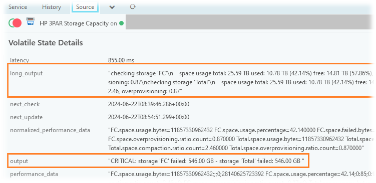

How can I get output and long_output data as a variable? We see this data on the “Source” tab in the “Volatile State Details” section. This is needed for our notifications plugin.
The $service.output$ variable works, but returns full information (output + long_output ). I tried using $service.state.output$ and $service.state.long_output$ variables, but they don’t work (the value of the $service.state$ variable is returned)

Thanks for the answer. But I didn’t quite understand how to do this. Can you give an example using the data from the screenshot?
