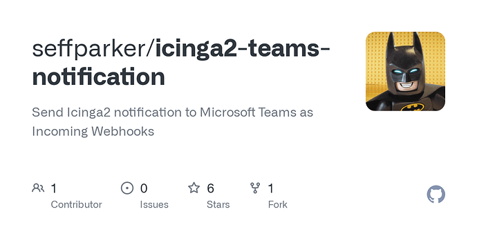

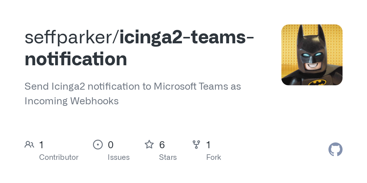

Maybe you could use the Teams integration via Webhook as inspiration.

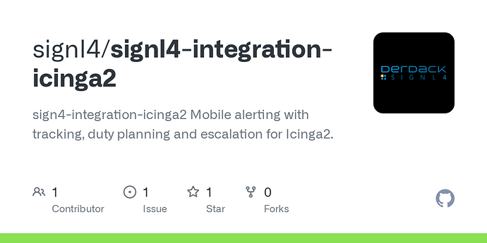

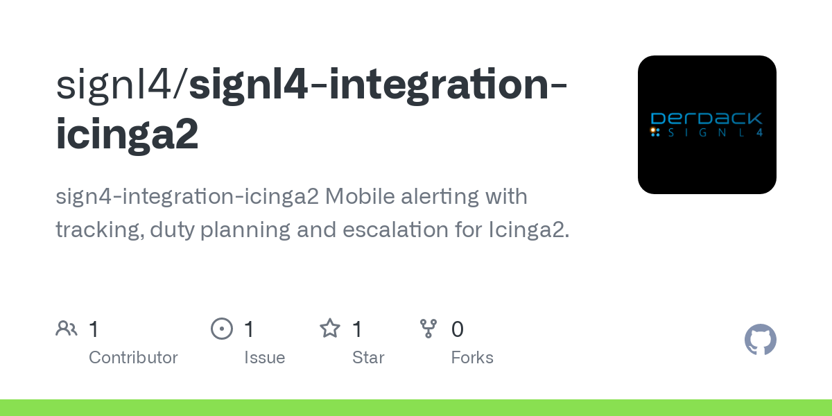

Hello, we have created an integration for SIGNL4 alerting using bash scripts. You can find it here:
The idea is to send an HTTP request to a REST API. Maybe this helps you.
