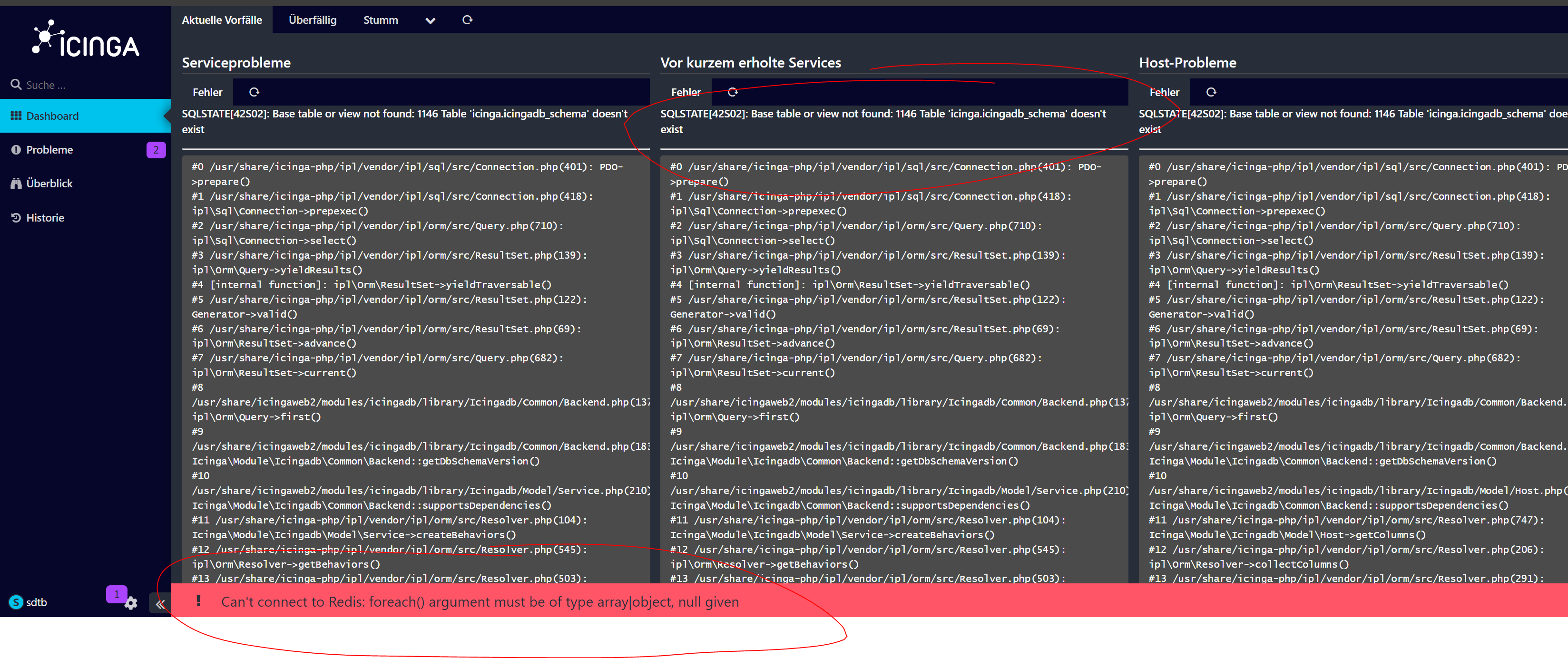

I skipped the validation.
At the end I can logon to icinga2 web frontend. But same picture here.
But .. SQLSTATE[42S02]: Base table or view not found: 1146 Table ā€˜icinga.icingadb_schema’ doesn’t exist
Missed I a step within the wizzard?
Maybe you missed to import the schema into icingadb?
Read Setting up a MySQL or MariaDB Database¶
Please compare these two log messages from your last two posts. First, the Icinga DB daemon has imported its schema successfully, now Icinga DB Web complaints about missing tables.
Since you work in a containerized environment, I would guess that maybe your relational database’s storage is not in a persisted volume, but was deleted during container restarts?
Please take a look at the Icinga DB installation documentation for containerized setups.
Otherwise, please share more details about your setup, perhaps a Docker Compose file if you are using it.
You are absolutely right.
Persistence was not given due to missing mapped storage volume.
That is solved.
Redis is not working yet, but I’m on it.
I will create a summary if it is solved.
Thanks for your food for thoughts.
