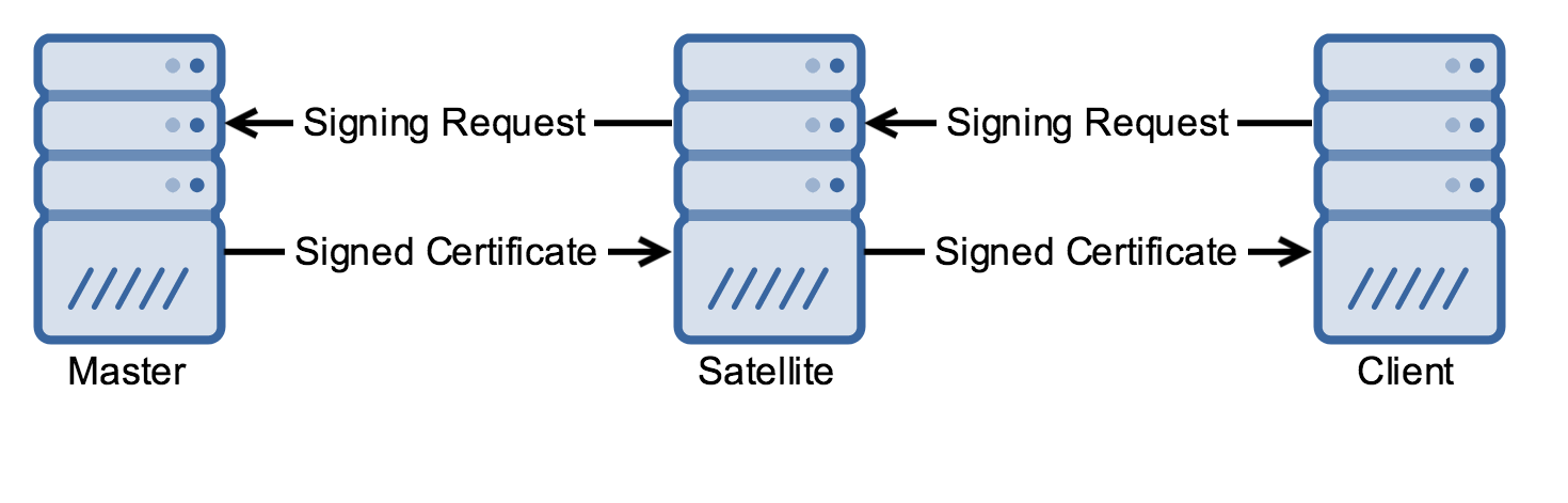

Hi Nick,
can you please explain how one could verify if the ca-proxy really works?
here is a blogpost about the ca-proxy:
here are the docs:
here is one thread about it:
In summary:
A ) you send the cert request to the satellite with the correct ticket and your certificate gets autosigned
OR
B) You send the cert request to the satellite without any ticket and your masternode should have the request, and you can sign it there
icinga2 ca list
And if I remember correctly you have to have the api feature enabled on the satellite and listen on 0.0.0.0 or your device ip

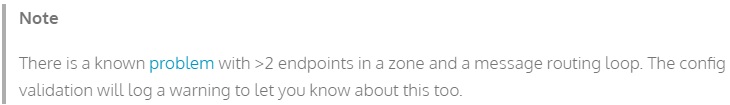

But I am currently experiencing a strange problem; We have multiple zones, exactly one zone sat-zone-1 has two satellites where the auto-renewing of the agents did not work and the agents were not checkable anymore. In another zone sat-zone-2 with exactly only one satellite, auto-renew worked.
This is the first renewal (we initiated icinga-agent in Q2 2024) so I can not verify
  • if the satellites of sat-zone-1 are configured incorrectly (in which way ever..) and the sat-zone-2 with a single satellite is configured correctly
  • or if the installed icinga-agent on the agents where auto-renewal did not work was installed / configured incorrectly. As they were the first to be installed and I tested around with them while building the ansible playbook I can not rule that out.
Maybe you have an idea what the issue is. As zones with max two endpoints are supported, I can not believe that the problem occurs because of the two-agent zone.
