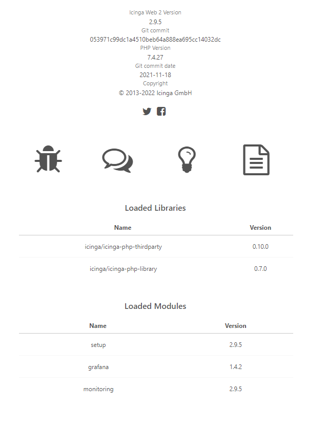

  • Icinga Web 2 version and modules (System - About)
