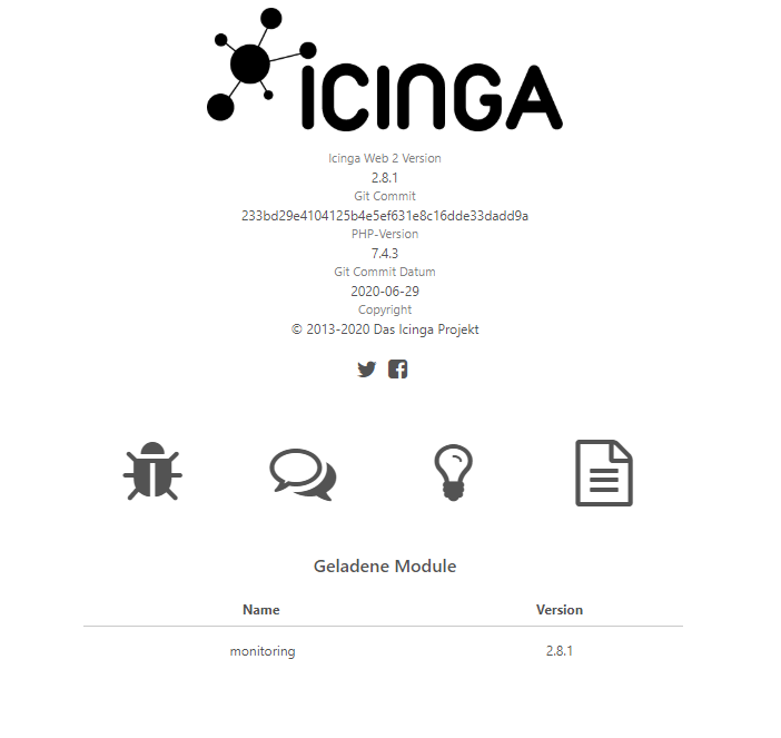

icinga2_1
phylipp
Are you using the director?
