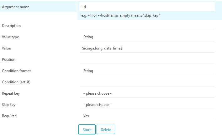

Hey @ritzgu , thanks for the fast reply
I did create the external command, if that’s what you mean:
I’m wondering if the director itself isn’t able to open the script, because longdatetime is the first param needed. Or if I kind of have to create all the params through fields myself? I pretty much created all of it through the guides provided from icinga.
I’m now just working through the debug logs and will provide you with informations as soon as I get them.
What I mean is: Did you add all arguments in the “Arguments” tab?
No I didn’t add them, thanks for this input. I will work it out.
I think this will solve your problem. :slight_smile: Good luck with your final thesis.
Kind regards
@ritzgu
Hey @ritzgu , it was exactly this fault. Thanks for helping me out, cheers!
