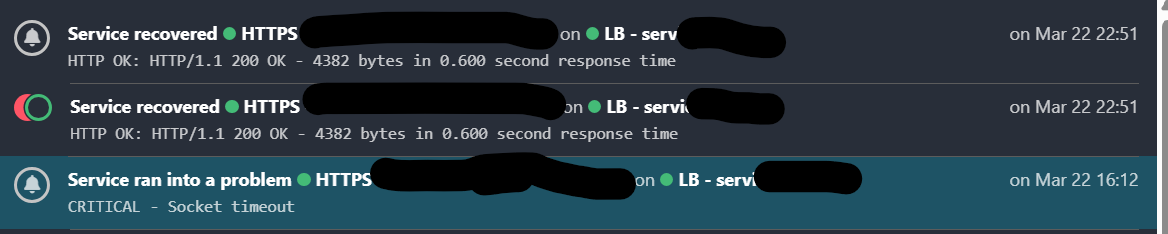

Hi!
I noticed that the last 3 days since the last patch some notifications did not work correctly and couldn’t find out the problem. May someone from the developers can explain this behaviour?
The problem is that at some notification events an OK transition is send and the previous CRITICAL notification is missing . Unfortunately I cannot reproduce the failure.

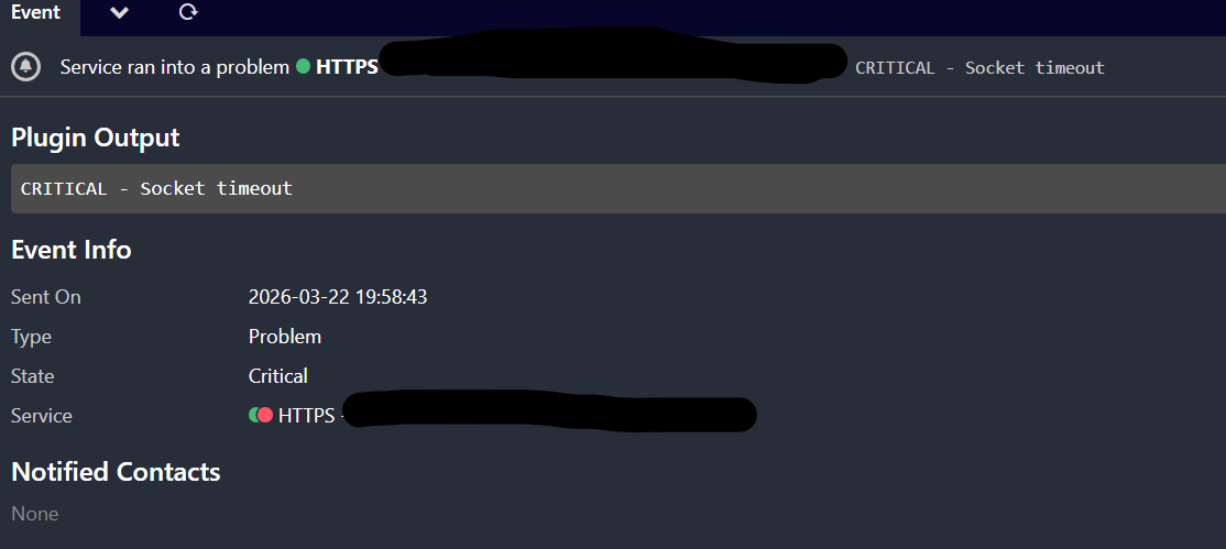

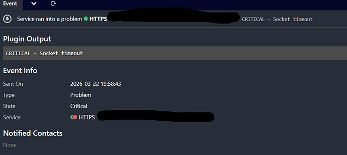

Here an example:
The critical event is triggered from the engine but the Notificaton Contact is set to None

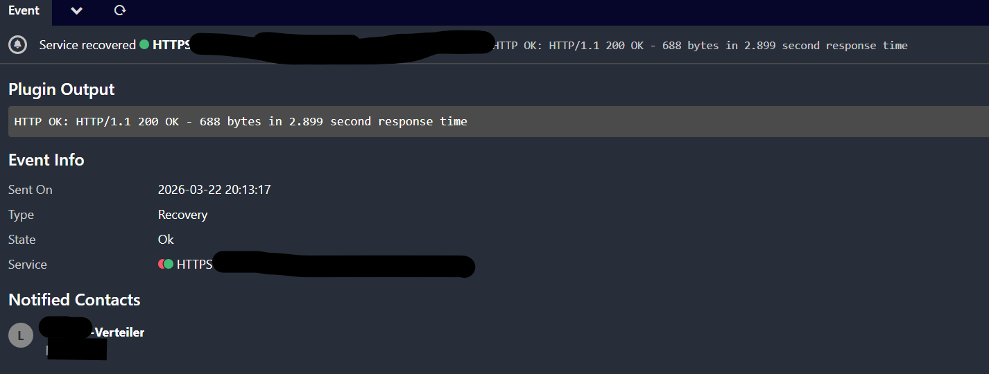

The OK event is triggered with the correct Contact:
I am not sure if this proves that the filters a correct. However I rechecked the the filters of course but they are definitely correct. The service should trigger at both events (CRIT and OK)
I cloned the same notification rule responsible for this failure and did tests and they behaved all as expected correctly.
So can anyone direct me into the right direction or can someone explain me why the Contact at the CRITICAL event is set to None?

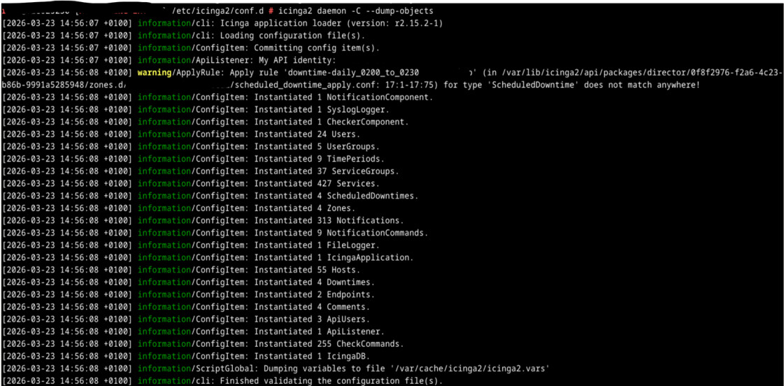

Is there anything relevant in the Icinga 2 logs? How does the icinga2 daemon -C --dump-objects output look like?

[2026-03-24 10:35:53 +0000] information/Notification: Completed sending 'Problem' notification 'docker-master!mail-icingaadmin' for checkable 'docker-master' and user 'icingaadmin' using command 'mail-host-notification'.
