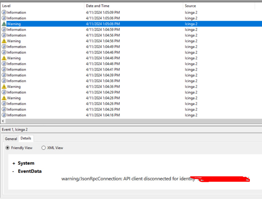

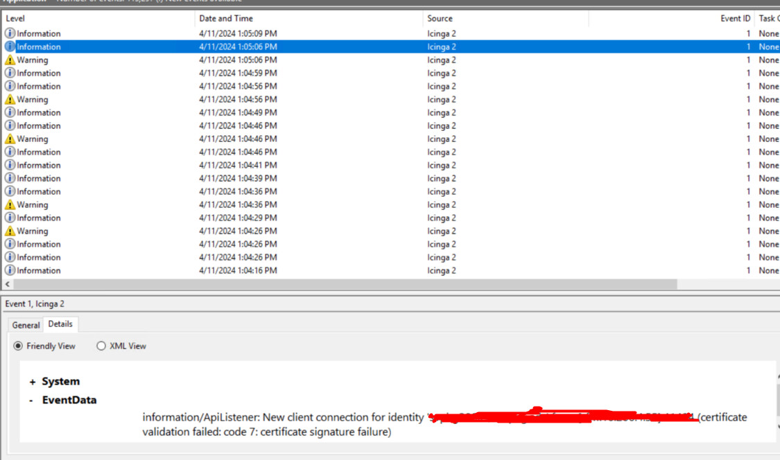

Today when I check the event viewer on my windows agent . and I saw many warnings

I don’t think these are normal .
When I write icinga2 ca list --all it also returns empty. However , I signed certificates when I did the connection I am pretty sure .
Everything works normal but it seems something is wrong .
What could be the reason of these things and how can I solve it ? Anybody have idea ?
