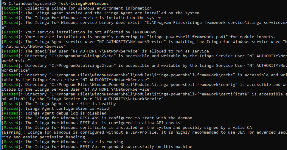

With IfW-Framework 1.13.3 the output should look similar to this:

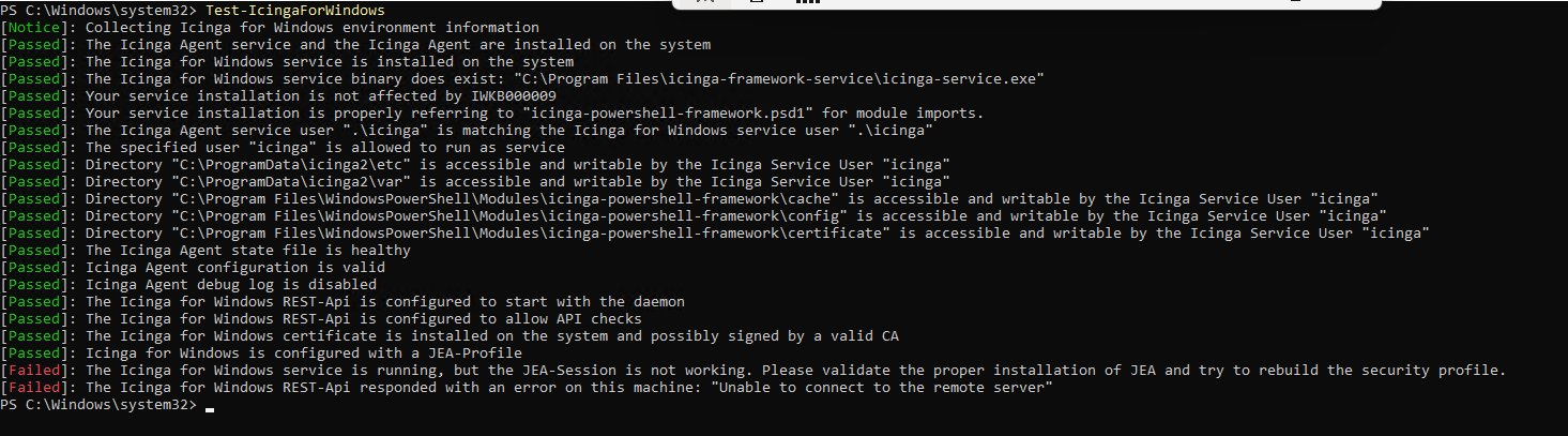

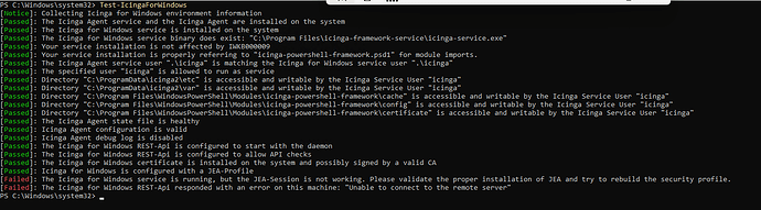

Hi Henning,
no, I is still have this Problem. The output of your command is:

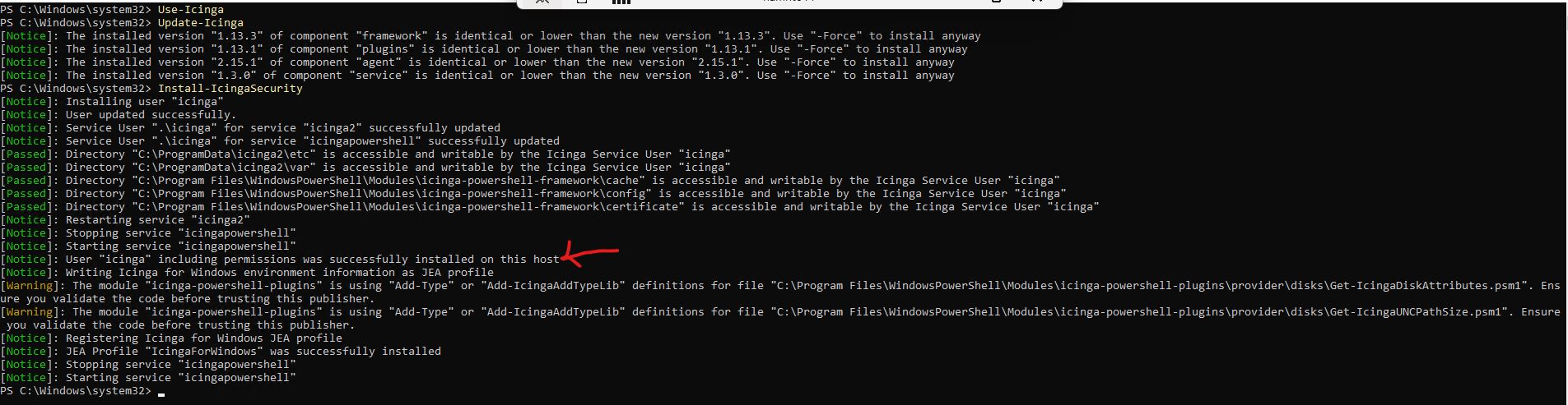

I wanted to make shure to have the latest version, so I did:
Use-Icinga Update-Icinga Install-IcingaSecurity
It’s telling me. The JEA profile is succsessfully installed.
Still, “the computers says NO!”
I am getting the same error from the first screenshot.
