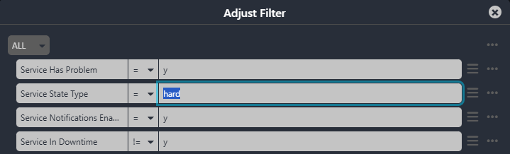

If retry_interval is 5min and max_check_attempts is 4 you will get a notification 15min after the first check failed.
In my dashboards I filter out soft states and only show hard states.
@rivad increasng max_check_attepmts resloved our issue for now. Thank you.
