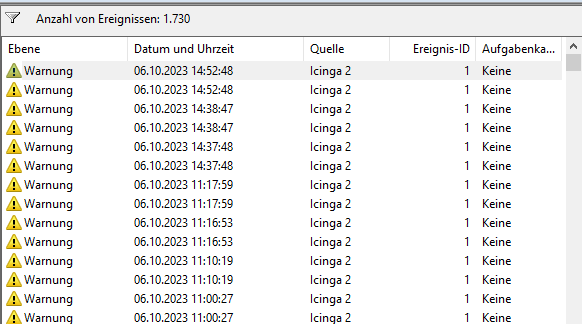

I’m encountering recurring log entries across multiple hosts that read:
warning/JsonRpcConnection: API client disconnected for identity 'servername'
warning/ApiListener: Removing API client for endpoint 'servername'. 0 API clients left.
While checks mostly operate as expected, sporadic connection losses do occur. I’m unsure of the underlying cause and would greatly appreciate any insights or suggestions. Please let me know if additional configuration details are needed.

Hi thanks for your answer.
I am not sure if its all fine.
There are a lot of entries in the eventlog.
And it also shows as Remote Host is not connected from time to time.

can you correlate the eventlog entries to director deployment logs?
you are right. The errors correlate to rollouts on icinga Director.
