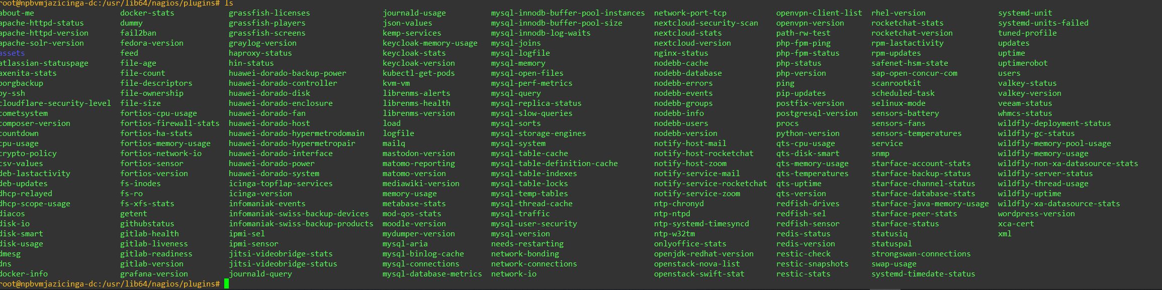

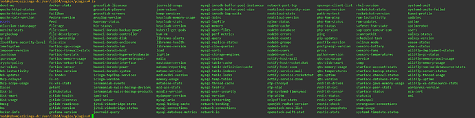

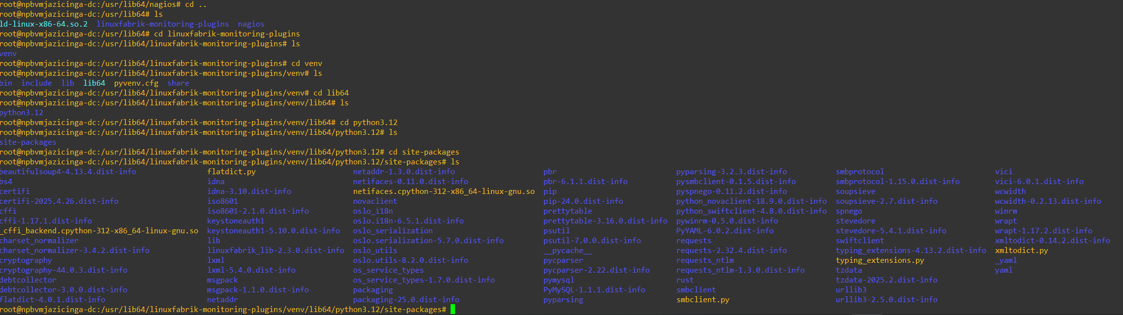

Ok, my work is blocking github, so I can’t do the clone command. I have downloaded the file: monitoring-plugins-2.4.0.tar.gz. Where should I unpack the entire file before trying the other commands?
Also, I already installed a linuxfabrik-monitoring-plugins file, was that for nothing or was it a pre-requisite? (see pictures)

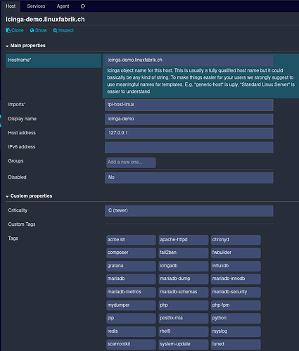

Now you’re ready to use the plugins by using the tpl-host-generic at the root of your templates to get the necessary field like Tags and Criticality. I cloned Tags and called it Custom Tags to manage the service-sets I build to monitor our bespoke applications.

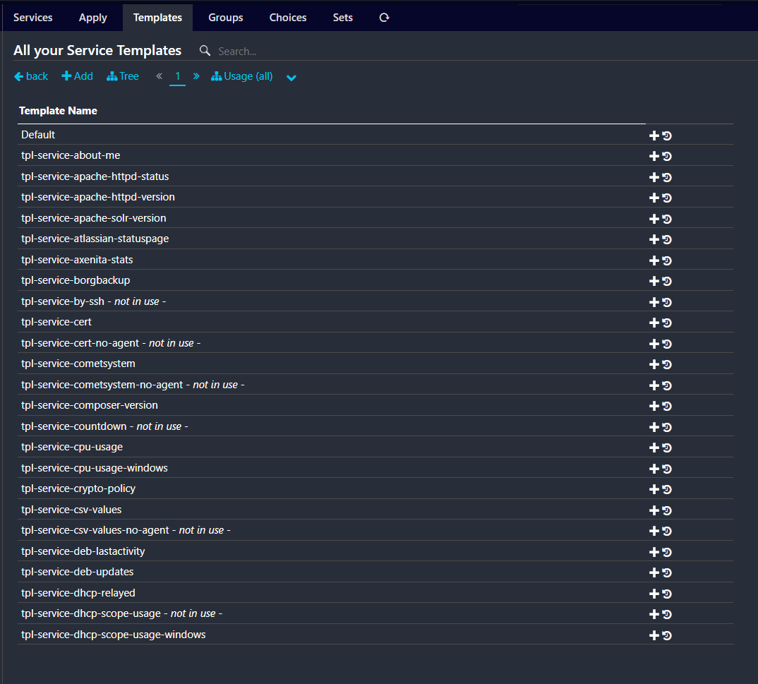

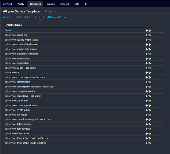

Ok, I was blind. I followed the instructions and now I think it worked (mostly) I’ve got a handful of service templates. Is this all I need for ALL the plugins??? It seems a bit small. How do I go from here to setting up things like CPU/disk checks on my Windows Servers?

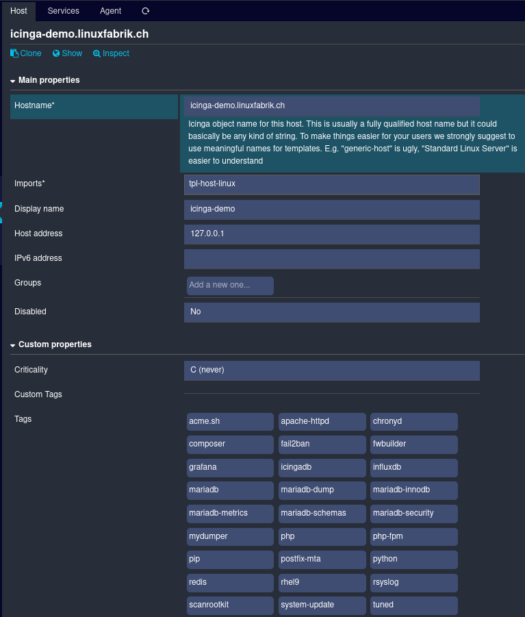

Hi @TowerMark what are you stuck on right now? Seems like you managed to import the config into the director, correct? You should find the other service templates on the next page (blue >> next to the 1 at the top of your screenshot). We provide Service Sets for operating systems and applications, which can be applied to a host via the Tags, for example on https://icinga-demo.linuxfabrik.ch/
