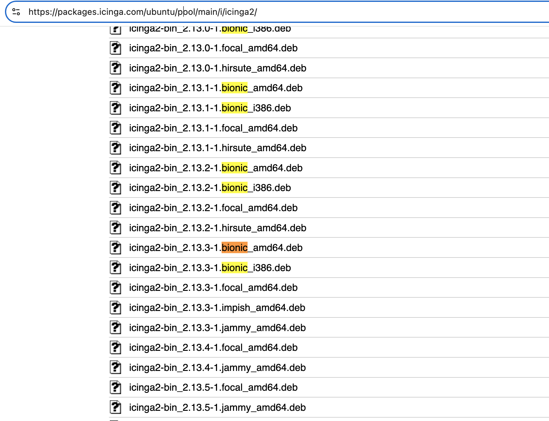

and the old packages are still there:
but they are signed with the old key, which is available from some internetwayback machine or you set the repo to
deb [trusted=yes] ....
but with 18.04 your are stuck at icinga2 2.13.3
