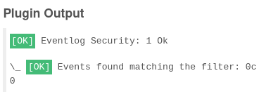

However, in the Icinga web console it never changes status. It just shows OK:
