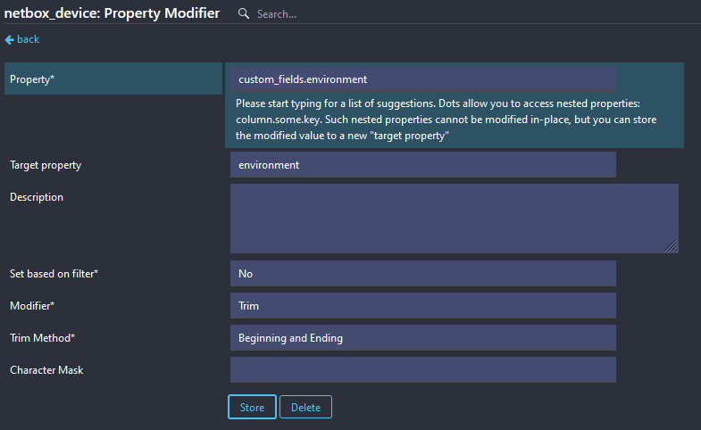

I want to filter on a custom field so I previously create a modifier like this
And next I set the filter expression into the import source rule like this

Yes I flat the custom field with the propertie modifier as shown on the screenshot (but maybe it’s not the good way)

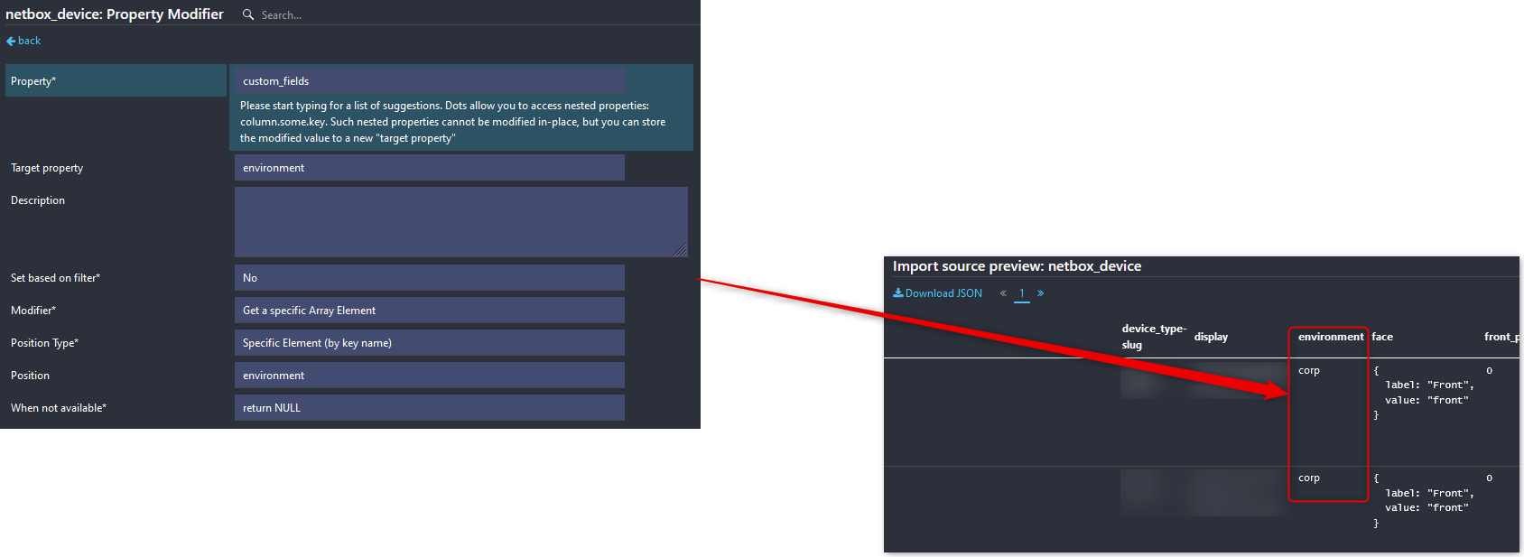

I already use the property modifier to get subvalue of the “custom_fileds” object.
When I watch the preview of the import I can see value I need, in the variable I configure.
In my search filter I set “status=active&environment=cust” and, as you can see, object with environment not equal cust (“corp” in my screenshot)… Maybe the problem is just with my search filter ?
