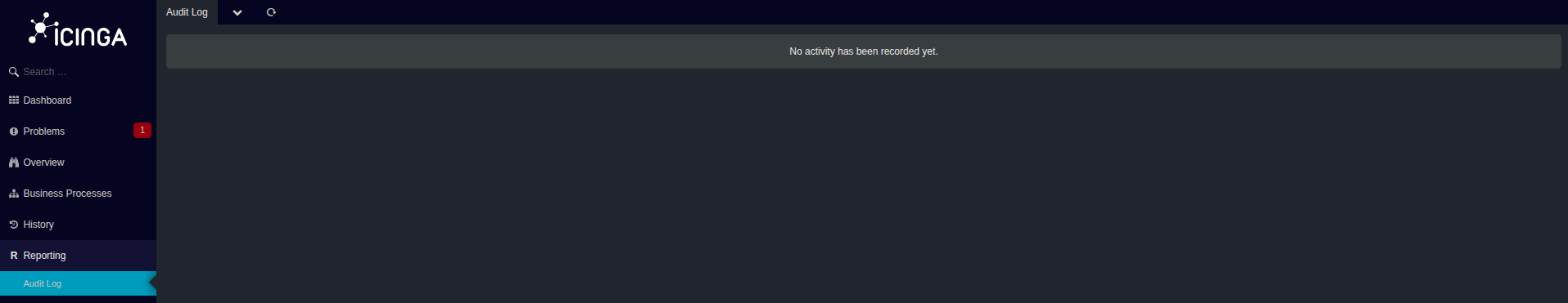

I installed the audit module, configured to “file” with default file path but nothing is shown in the tab, with the message “no activity has been recorded”.

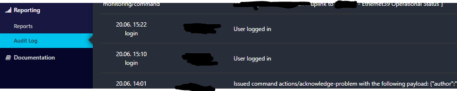

This is what the audit module gives you when working:
Don’t you see that?

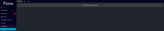

I have the audit module, but nothing shows…

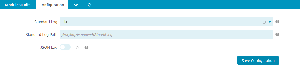

Config is :
  • standard log => file
  • standard log path => default

did you adapt the settings for the module:
yes i did but as Alvar said, i’ll check my dockerfile for php writing rights
