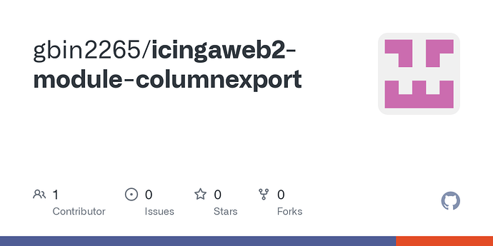

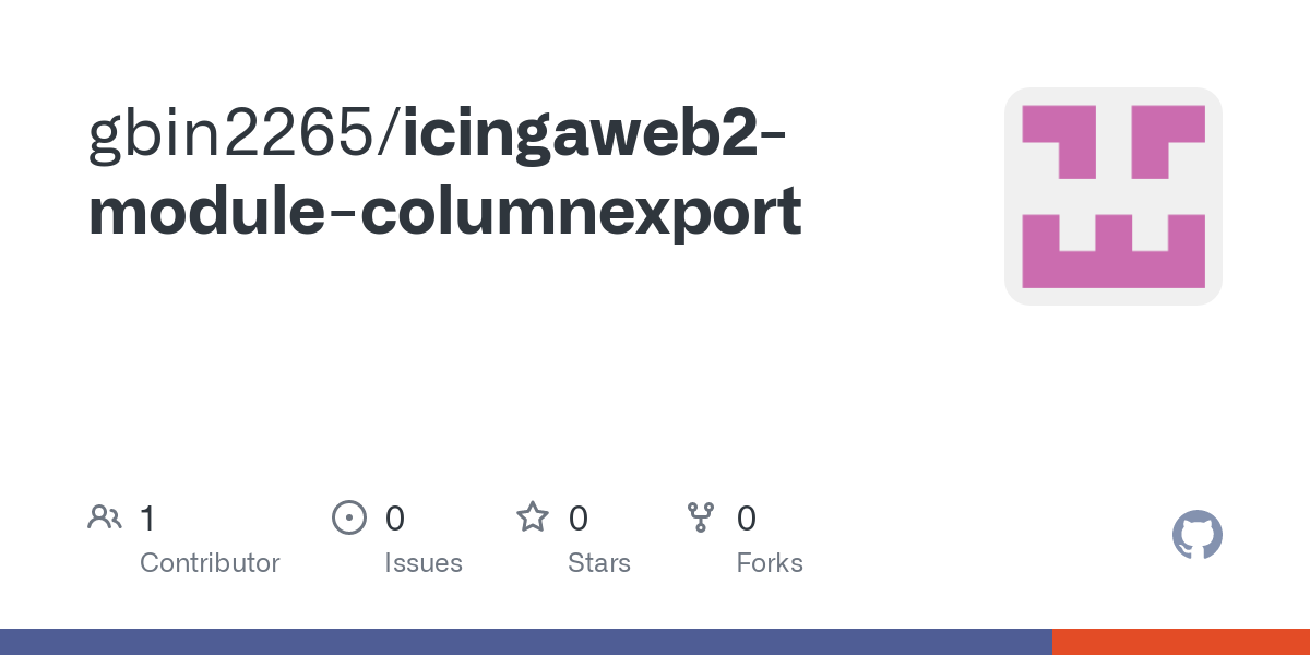

Hello @moreamazingnick
I’ve create my module and uploaded it to GitHub.
There’s a small description of the module and in the documentation section there are instructions on how to install/configure it.
The only thing I’d like to improve now is the header of my page.
I’d like to be able to set the title, with the refresh symbol next to it, and the close button on the right.
I thought this could be done for icingadb-web by placing the following line at the beginning of the code,
$this->addTitleTab(t(‘icingadb/hosts’));
but it does nothing at all.
Do you happen to know what I need to change in my code to display the title, refresh button, and close button on the screen?
