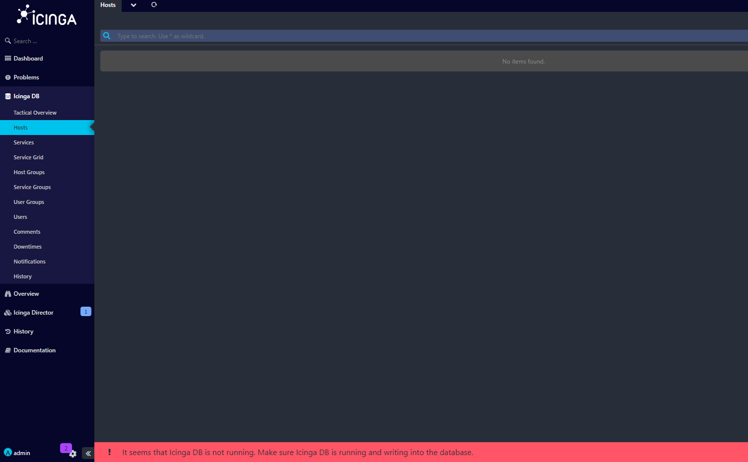

ICINGADB Service - Error 1045: Access denied for user 'icingadb'@'localhost'
I have just updated OS from Ubuntu 18.04 LTS to 20.04 LTS
After that I have installed the icingadb as per:
https://icinga.com/docs/icinga-2/latest/doc/02-installation/02-Ubuntu/#set-up-icinga-db
After the installation, the command
systemctl status icingadb
return me this:
I have verified the settings into the file
/etc/icingadb/config.yml
And seems that are ok.
Ihave also noticed from PhpMyAdmin that the user icingadb do not have the “GRANT” on icingadb Database. And Even if I try to assign the GRANT - this do not work.
I have the same error.

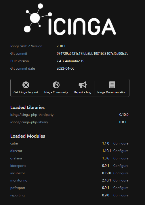

Which version of icingadb and icingadb-redis is installed ?
Because icingadb is not enabled yet i seen on the “About” screen.
Is this version 1.0.2 ?
