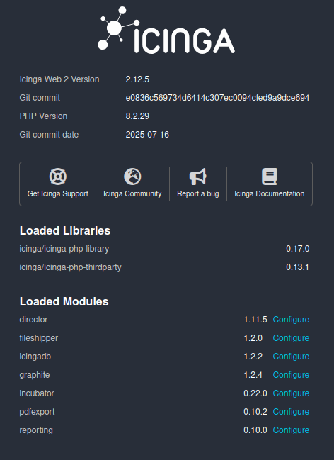

  • Icinga DB Web version (System - About): 1.2.2
  • Icinga Web 2 version (System - About): 2.12.5
  • Web browser: Firefox
  • Icinga 2 version (icinga2 --version): r2.15.0-1
  • Icinga DB version (icingadb --version): v1.4.0
  • PHP version used (php --version): 8.2.29
  • Server operating system and version: Debian 12
