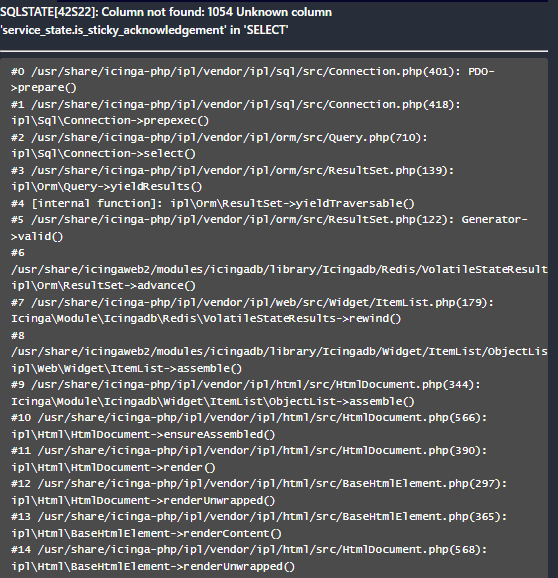

Your solution worked, and ICINGADB has restarted. However, I have another problem related to IPL. I have already updated IPL to the latest version. Any ideas?
you should recreate the icingadb database because some migration steps are not done correctly.
alternatively you can check each migration manually and check if the changes have been applied.
if there is an add column your column should exist in the database’s table
The Icinga DB Web error complains about the missing is_sticky_acknowledgement column in the service_state table. It was introduced in version 1.4.0.
As both @moreamazingnick and myself already wrote, starting from a blank new schema would be the easiest way to go unless you have an untempered database backup you can restore and apply the missing schema upgrades upon. Based on my earlier response, this backup should have been created before Thu Apr 17 07:04:31 PM UTC 2025.
