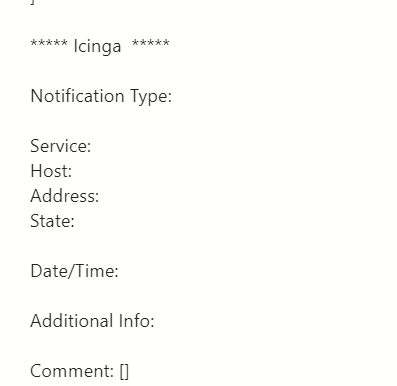

Hi @log1c - i have done the setup , when i run the mail script , , it fetching email as below
my requirement is to get the server weekly report as shown below in the Email , can you let me know how it will get possible?
