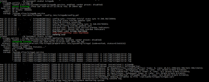

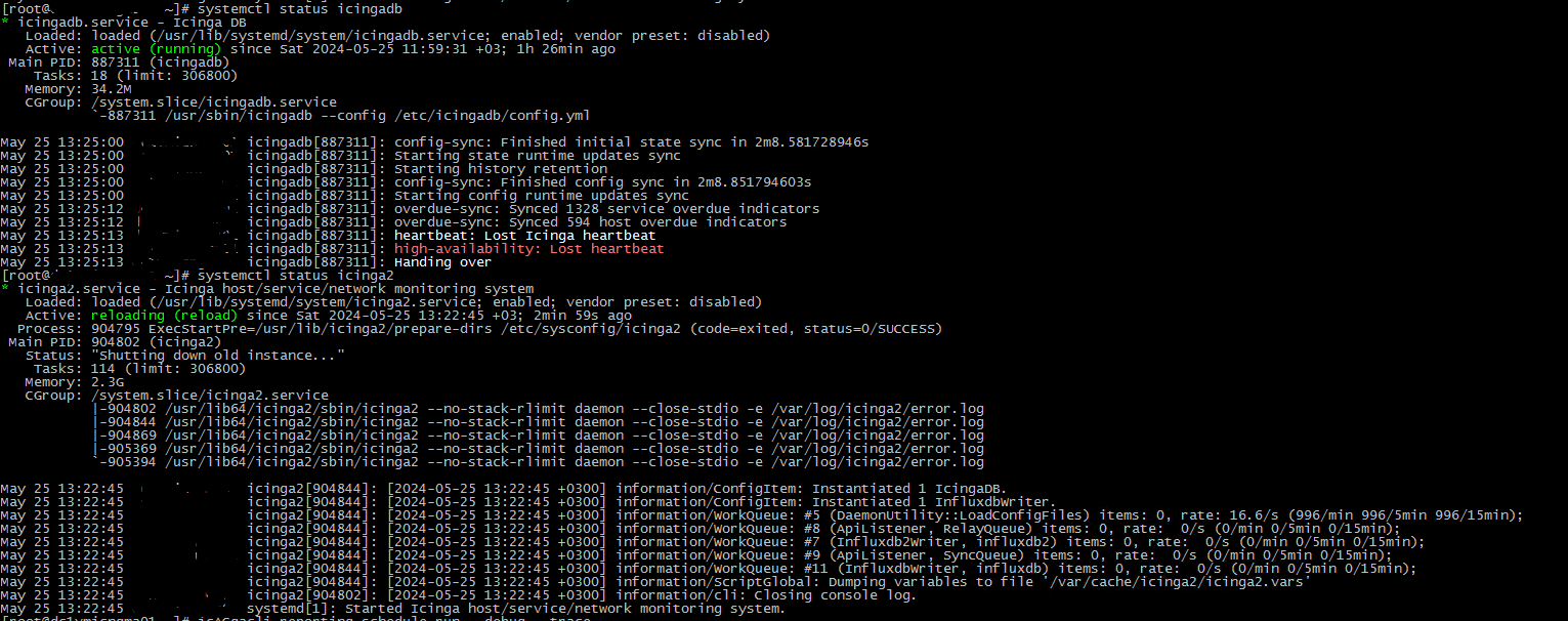

When I deploying configuration via director then icingaweb notify to me icingadb is not running.
I checked icingadb service is running but icingadb status is “Handing over”. I think the reason of this, icinga2 service is not running because its waiting reloading:

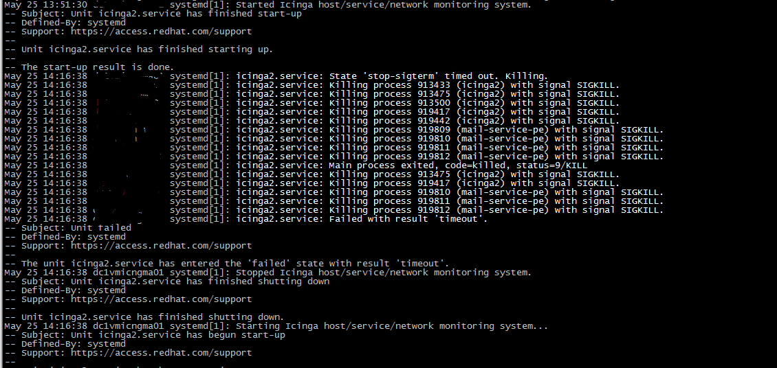

I check icinga2 service history with this command “journalctl -u icinga2 -x”, then I saw “icinga2.service: Failed with result ‘timeout’.”
How did I solve it, I run service restart command on cli then everything is ok.
I think when I deploy configuration then director restart icinga2 but this operation does not wait for old processes to kill or timeout value is short.
