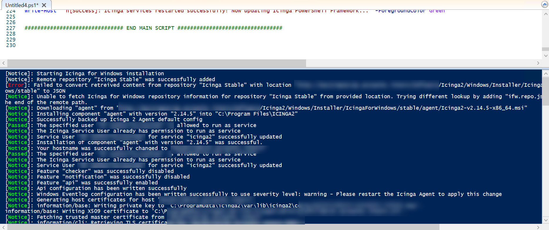

Our repository stores different versions of Icinga components, and we have a custom script to install the Icinga2 agent. Recently, while attempting to upgrade the agent, we encountered the following error:
[Error]: Failed to convert retrieved content from repository "Icinga Stable" with location "http://****/Software/Icinga2/Windows/Installer/IcingaForWindows/stable" to JSON
This issue arises when updating ifw.repo.json to pick up the latest Icinga PowerShell Framework version (e.g., 1.13.0 or higher). The installation works fine with version 1.11.1, but any attempt to use a newer version results in the above JSON conversion error, regardless of how many times we try.

After making this change, we repeatedly encounter the following error during installation:
Error Message:
This error persists regardless of how many times we try to install the agent using the updated ifw.repo.json.

I have followed the steps you suggested and tested the JSON file. Here are the results:
Commands Executed & Results
. Loaded JSON File:**
$JsonString = Get-Content -Path "C:\temp\ifw.repo.json" -Raw -Encoding UTF8
Successfully loaded the JSON file without any errors.
. Tested JSON with Test-IcingaJSONObject:**
Test-IcingaJSONObject -InputObject $JsonString
Command executed, but still getting the same error.
Converted JSON to Object for Verification:**
t
$JsonObj = ConvertFrom-Json -InputObject $JsonString
JSON parsed successfully without any errors.
Checked JSON Structure for Any Issues:**
$JsonObj | Format-List
The JSON structure appears correct and contains expected key-value pairs.
Manually Downloaded JSON to Check for Corruption:**
Invoke-WebRequest -Uri "http://<MyRepo>/Software/Icinga2/Windows/Installer/IcingaForWindows/stable/ifw.repo.json" -OutFile "C:\temp\ifw.repo.json"
File downloaded successfully. Opened in Notepad++/VS Code, and the formatting looks fine.
Issue Still Persists
Despite the JSON file being correctly formatted and successfully parsed using ConvertFrom-Json, I am still getting the same error message when running the installation.
I’m cluseless here what could be cause and how it can be solved
Would appreciate any further guidance!
