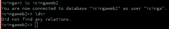

I am using PostgreSQL for my databases. You can ignore “icingaweb” database.
My main database “icinga” does have his tables but my “icingaweb2” database is empty.
Hm, then the setup did not create/import the schema for the database, I guess.
