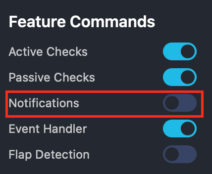

The new Icinga Notifications module does not seem to honour when notifications for a service/host is disabled in Icinga Web.
Even if notification is disabled for a check, it still gets picked up in the Notifications module and sends out a notification message.

Thanks for posting and please excuse the confusion.
These Feature Commands are part of Icinga DB Web, allowing to alter the Icinga 2 Host or Service object.
Thus, if you toggle the Notifications feature, this only relates to the Icinga 2 Notifications, but not the new Icinga Notifications project, allowing also other notification sources outside of Icinga 2.
Again, please excuse the confusion. We should definitely look into this to unify these things, e.g., synchronize the altered notification state from Icinga 2 to Icinga Notifications.
