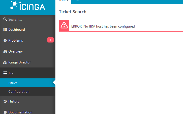

I try to configure Icinga Jira Module with Jira Cloud, but when try to test the connection this fail with this errors.
ErrorException in /usr/share/icingaweb2/modules/jira/library/Jira/RestApi.php:401 with message: A non well formed numeric value encountered
icingacli jira send problem
–host icingaweb
–project ITSM
–issuetype Incident
–state DOWN
–description ‘Base Abajo’
–summary ‘CRITICAL - 127.0.0.1: rta nan, lost 100%’
Any limitations with Jira Cloud?.

how are you trying to test the connection?
I’m dealing with JIRA module issues regarding a there is not way to connect it to my Jira cloud trial account.

I pull this up.
Does anyone have some tipps how i can configure the module with jira cloud? Because there is no user and password login for api anymore. Espcially if you are using an saml provider
Thanks.

Looks like this could be the corresponding issue:
opened 02:40PM - 18 Jun 21 UTC
enhancement
As an alternative to login with user and password, login with a token should be … possible.
`[api]
host = "jira.example.com"
; port = 443
; path = "/"
; scheme = "https"
; username = "icinga"
; password = "***"
token = "****************************************************"`
teqqy
(Christian)
August 5, 2024, 1:02pm
11
Thanks. This workaround works quite fine for cloud.
