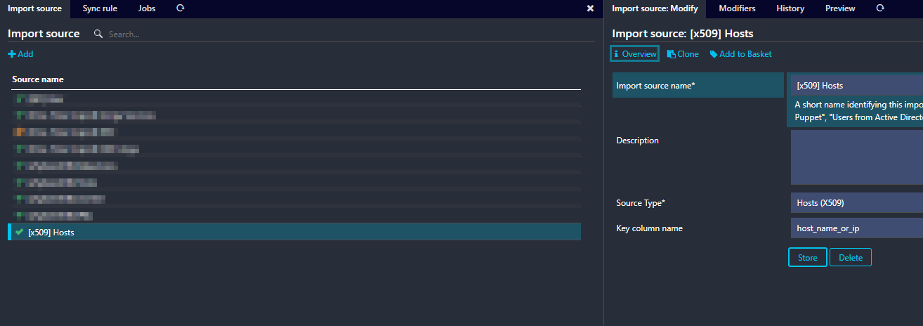

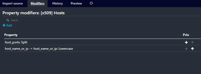

I currently have the following problem. I want to import x509 hosts via the Icinga Web 2 module and have set up a corresponding automation in the Director:

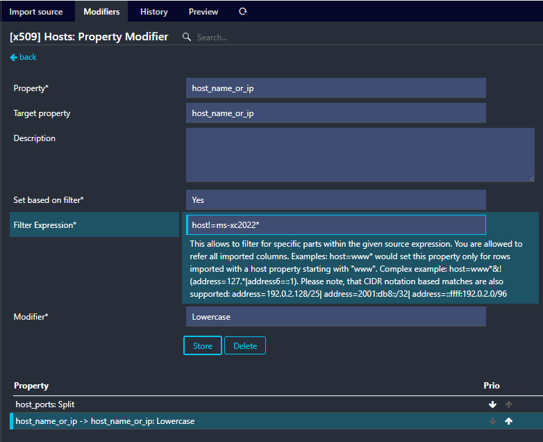

This works so far. However, I would like to create an exception for some hosts so that the hostname isn’t converted to lowercase for them. Can I somehow influence this using filter rules? I’m asking, especially because I haven’t been able to do this using any rule I know of (object_name, icinga_host, host, address, etc.):
In the example above it would be a matter of setting an exception for hosts such as ms-xc2022A.example.com and ms-xc2022B.example.com to prevent a conversion to ms-xc2022a.example.com and ms-xc2022b.example.com.
With negation, it also seems to make no difference whether I apply it only to the expression itself (host!=<HOSTNAME>) or to the entire expression (!(host=<HOSTNAME>)).

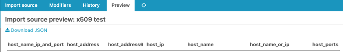

there you can see all the properties that are available for querying:

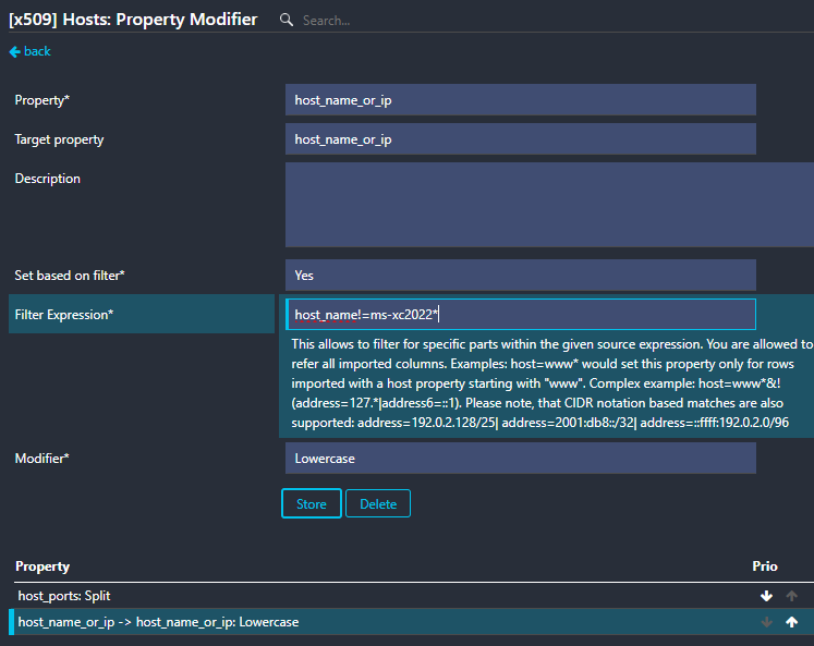

as you can see there is no column named host but on named host_name so your filter can be:
host_name!=ms-xc2022*
and then you can check the preview to see the changes.
The help text is very generic because different importsources can provide different data.

I’ve got the following columns at the import source:
grafik
However, the example systems are always converted to lowercase. It doesn’t matter whether I set the filter to host_name_or_ip, host_name or simply host_address or host_ip. The filter is ignored every time.

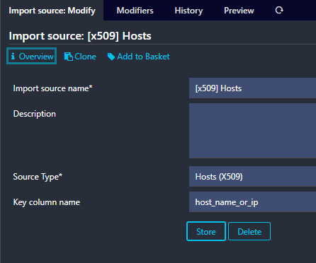

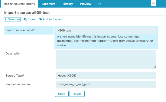

The import source itself:
And the filter:
Best regards
Torsten
these are not director hosts these are x509 hosts.
can you remove the the filter and check the preview again, the might all be lowercase anyway.
so what you might need is a propertymodifier that uppercases your hostname.
